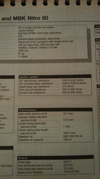

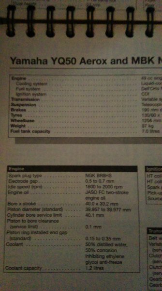

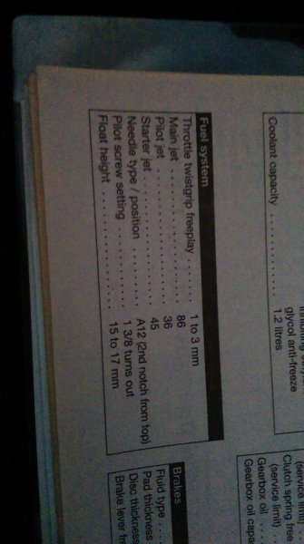

    Any way here are the factory settings IMAG0416.jpg IMAG0419.jpg IMAG0418.jpg

    Oh thanks for that buddy it will help a lot, im going to put a new plug in get it warm and blat her down my road, its long enough to reach 30 mph and knock her off, im suspecting the jetting is off, as ive never messed with any of the screws etc. Time will tell.

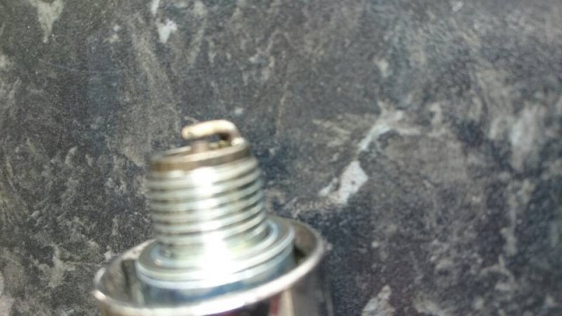

    Its as lean as you like, i see the manual state a b8 rated, this is running a b7 ? This affect anything at all ? uploadfromtaptalk1460288595647.jpg
    Sent from my D6603 using Tapatalk

    I havent got an b8 plug to hand, i'll get one tomorrow afternoon.

    The 7 and 8 I'm pretty sure is heat difference In the plug mate don't hold me to it know

    Yeah it is heat rating. But im doubting it would affect the air fuel ratio. Im going to get the correct plugs tomorrow, and ive got jets anyway in my friends shop, so going to get them aswell, im guessing it can only be this. Everything else is spot on, my jets ranged from 90-100 odd.

    Well typically speaking, its only around a 10% rise on the jet, so its currently 87, so i'd be upping to around a 94-95. And im not a fan of the old filter business. If it works, just from upjetting, jobs a good'n.
