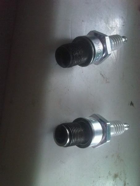

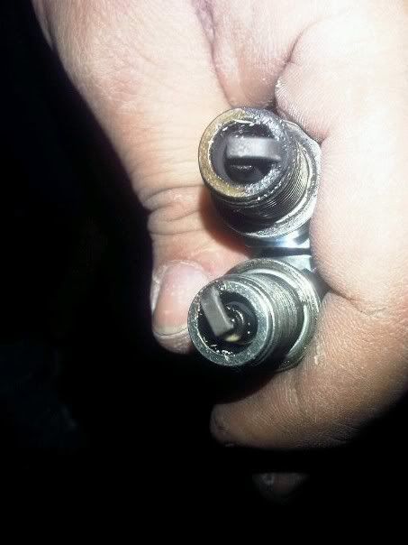

    the plug on the top was used for 9 miles the plug on the right was used for about 1 mile not even that i put it in idled livly went petral station 2 mins from my house come back and dident wanna idle plug was a tad wet too

    now the plug is not as wet but stil a bit black
