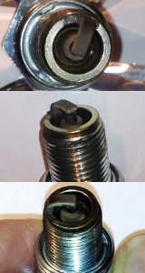

    However 50 miles on and still running bike carefully I have noticed that the temperature gauge was rising. Thought nothing of it as its Summer and riding in London stop and start etc. But on the way home tonight the bike just died. Had a quick look at the temp gauge and was just under half way. By side of road, put a new plug in and checked there was no air in the coolant by bleeding. Bike started and home I came. Then readjusted the air/fuel mixture on carb and let the bike get hot until fan came on, all seems okay. Changed over the spark to a new one and went for a ride for about five miles. Below is what the new spark looks like after a short ride, again temp gauge went to about half way and fan came on, rode around the block, and bike did not cut out.
    Just to add that the coolant is different to what I had previous, its the new Putoline Coolant NF green in colour, so washed out old coolant, blue, with water before adding new coolant.
    I've attached the photos of the spark plug, any advice on what people think. My worry is don't want to break down half way to work, getting on now and it kills me pushing the bike more than 50 yards.
    Thanks for any advice.

    It should have a 86 main jet if it's all std 125, make sure you have no air leaks on the intake.

    Had the carb off before coming to work and have a 96 on the jet, would this be the problem? Now that I renewed lots, more sensitive, never changed it so has been on for a while. Also as far as I can remember the temp gauge rarely moved previously.
    So 96 on a the moment, has this been my problem all along?
  6. 32Alan
    32Alan New Member
    17
    Got the new jet 86 and a standard idle jet 45, checked there was no air leaks and adjusted the carb. Place a new spark and went for a ride. Spark is a nice even chocolate colour with no oil, first time in years. However two things. Firstly, using a tachometre, I can't get the rpms above 4,000 using the idle screw, its all the way in, book state 4 to 5 thousand. Most importantly, the temp gauge is still rising to about 20% up on the dial, could this be the new organic coolant? Is this normal, I've been riding for years and don't remember it going that high, but for heavy traffic. Checked the pipes and bottle all are hot, so pump must be working...
