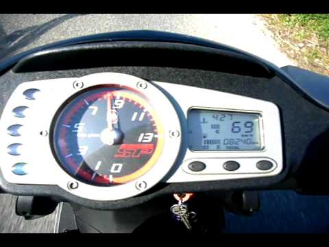

    Quite strange really. Check the temp probe if its faulty. Most of the time while sock mine was running like below photo hqdefault.jpg
    After 70cc conversion it added 1 bar plus.
