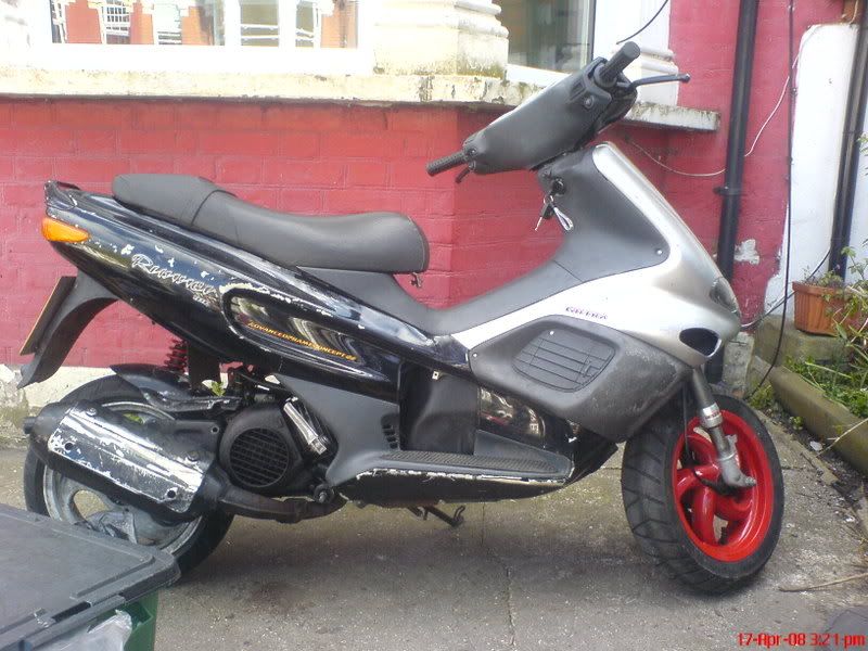

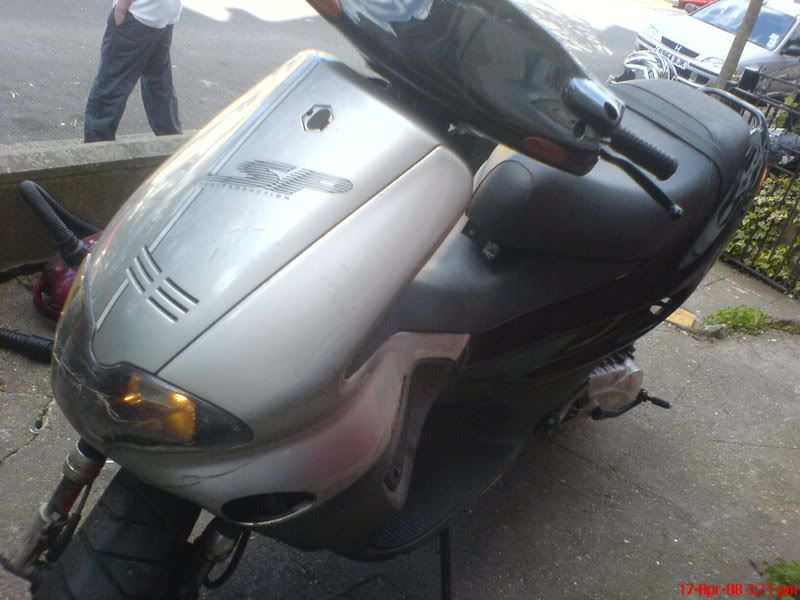

    Well tonight I swapped my Runner for another Runner but the kid has put a 125 Typh lump in it and it has 125 bars. The forks are in good nick and work fine, Also the rear shock looks basically new. The kid said that it just stopped running. It was dark by the time we had done the deal. There is good compression on it so it least the bore is okay. He said that he recons its something to do with the carb :msn1: :msn1: just my luck lol. So I'm gonna strip the carb and see whats going on in there. Gonna change the plugs and put some fresh petrol and oil in and go from there. The panels aren't in that good condition, actually there fucked but i'm not really too fussed. You would of probably seen it on Gumtree as that is how I come across it. Haven't got any pictures tonight. Will get some tomorrow.
    Edit: Have some pictures that the kid sent me.
    Well as soon as its running I'm going to get a new crank, mains and bore for it. And I'm gonna start on sorting the panels at the weekend most probably. Haven't got a clue what color I'm gonna go for yet. Had it like an hour and already started pricing things up haha.

    no offence but that bike is an absolute state :wtf:
  4. WOLFFY
    Well its not like I've done it. Hopefully it should be nice in the next 3-4 weeks.
  5. kyle1b1
    yeah is a real state.
