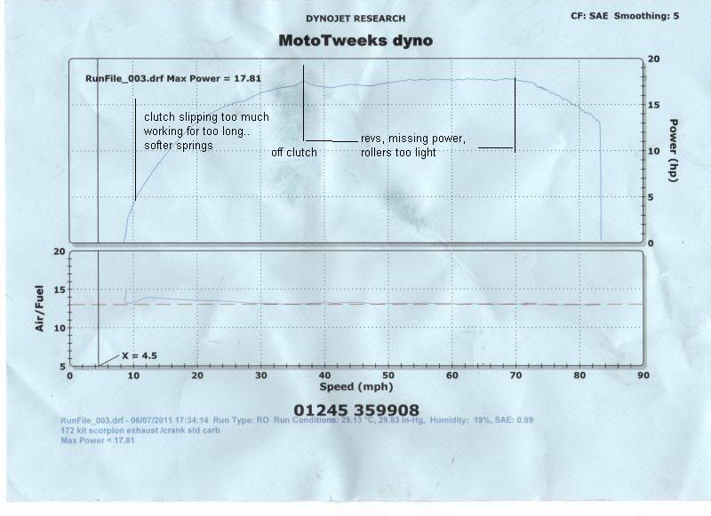

    Regarding the rollers I believe on that run the bike had 10g rollers as he didn't have any others close to what was needed. His recommendation was 12g. I've made a temp mix and match at 12.7g. Thing is off the mark it feels like something is slipping and the acceleration is disappointing. It doesn't feel like its bogging (unless the clutch is slipping at same time) but more like its all noise no go. I don't think it will wheelie where as standard it would with a little tug. Its not terrible and just in the 0-30 range off the mark needs tweeking.
    Im inclined to think I need 11.5g as the bike is trying to pull away in a higher gear but what i dont want to do is push the revs out of the pipes band, it feels nice at 30-80. I need someone to correct me on this as im trying to get my head around it properly. Another scenario that if my rollers are set to the right ranges for keeping the bike in the right power range theoretically if my clutch springs are a little tight then this would cause the same symptom woudnt it?

    just was thinking out loud there lol
    minor if you say the dip is the bike coming off the clutch then that means its slipping like it actually feels up to 35mph (also the graph shows). if i put lighter rollers in there then I may fix that problem but it will rev like hell. If i put 13.5 in there then in my mind it will get worse, it will try pull away in an even higher gear (meaning lower ratio)
  12. MiNoR cOnFuSiOn
    heavier rollers will put more resistance against the crank, you have the power to push this gearing tho so it wont affect the revs.. try 13.5's nwitht he stock clutch... you will get a little hesitation from 0 to 10mph wich is just the clutch biting lower.. get the rollers spot on. then put some malossi green's in there. if you run anything tighter than greens you will simply get slip at top speed (so wont pull your top speed)
    putting lighter rollers in there will just make the dip worse.. revs do not allways = power with these.. you need the variator to stop the engine revving via roller weight.
  13. MiNoR cOnFuSiOn
    sorry, seems you allready have a polini spring set... cant remember the weight order, but DEFFO the lowest strength and some heavier rollers :)
  14. MiNoR cOnFuSiOn
    ive marked whats going on here... springs are too hard so your getting smooth power delivery, but it takes too long/is slipping too much... can see where the power drops altho im sure the revs dont.
    could live wiht the clutch, but DEFFO heavier rollers... :)

    Can't believe how you can tell wahts going on! that's awesome! :p
