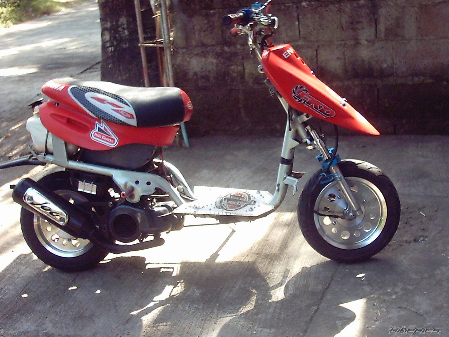

    So I decided to "modify" my scooter. I'm not really in it for performance, more just the general look of it. I'm not a huge fan of the sporty looking scooters with the plastic bodywork, what I like is the barebones look, scooters stripped down so you can see the guts basically.
    This is the kind of look i would like to go for with mine, but i'm not really arsed about it being so...err shiny I guess.
    Yamaha Jog CY 50-
    http://img.photobucket.com/albums/v84/xb0nerx/scooters/2006_02_06_bikepics-517203-full.jpg

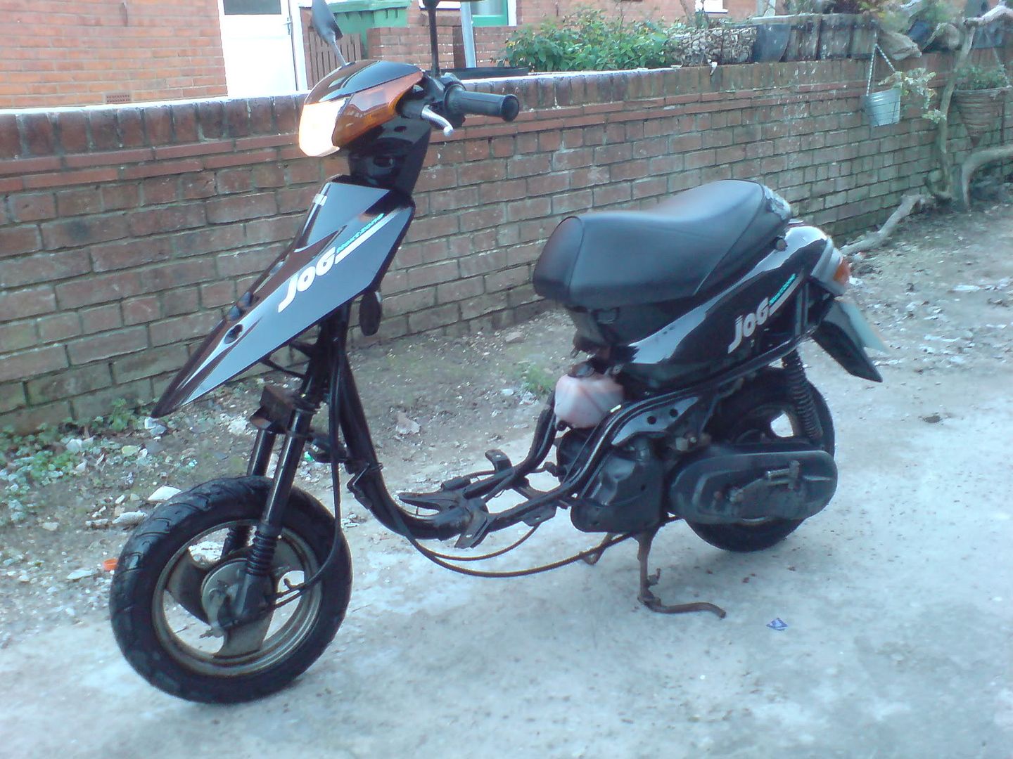

    And this is my Yamaha Jog at the moment, same model (not as good..yet) -
    http://img.photobucket.com/albums/v84/xb0nerx/scooters/stage5.jpg
    The main thing I want to change at the moment is the whole handlebar arrangement. I was looking at getting some downhill style handlebars and mounting a round twin headlamp setup on there (like what you see on streetfighters) with a digital speedo.
    Now i'm new to the whole scooter malarky so i'm pretty much playing this by ear and learning as I go. Is there any major problems I may encounter when trying to acheive what I want for the handlebar/light set up? I do want to be able to legally use this bike on UK roads. To my mind the most annoying part seems to be getting some indicators that will fit on downhill handlebars. I found some twin headlamps with indicators attached but they don't state on the website if they are e-marked.
    Cheers!

    haha 1991 so it's getting on in years!
    I was actually considering a front disk, but for now the drum is doing fine, i'll mark that one down for future attention. :p
