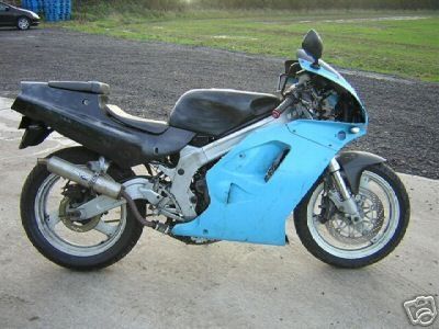

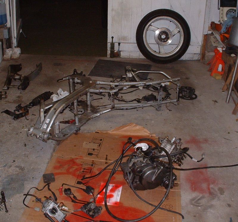

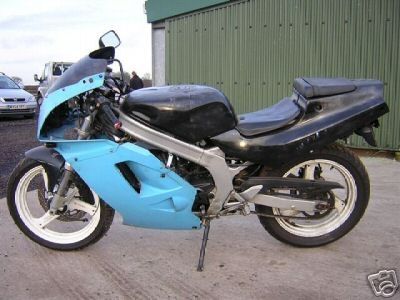

    Bought from ebay salvage dealer as a stolen recovered for £225 in February 2007 looking like it does in the pics below. Within hours of getting it home and finding it wouldnt start with a fresh battery and fuel it was swiftly converted to a pile of spares.

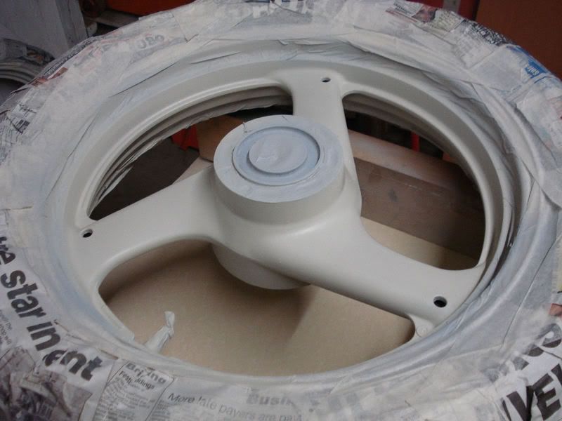

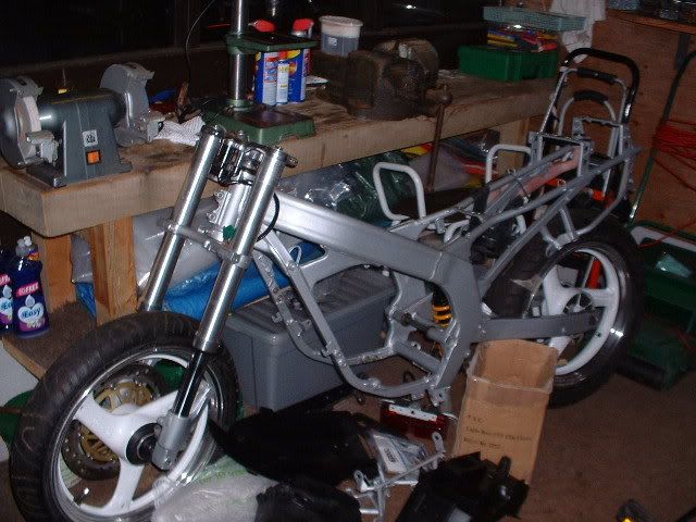

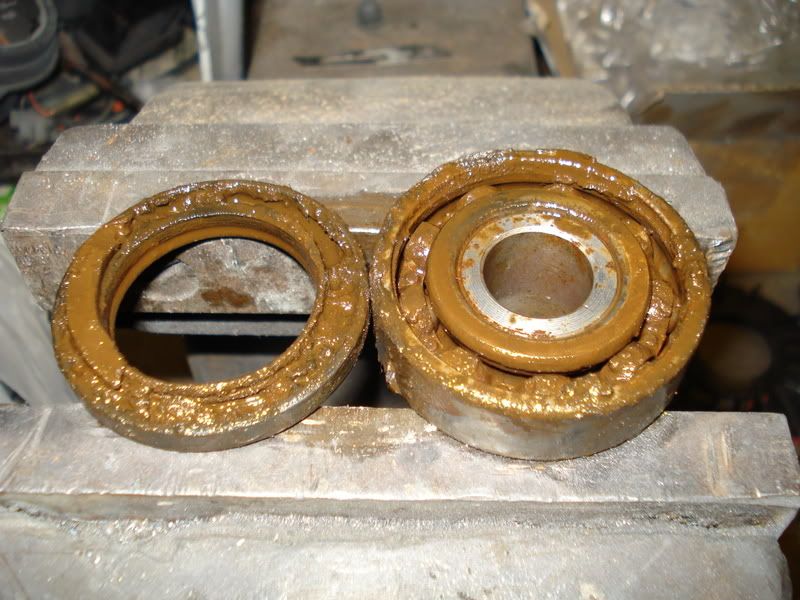

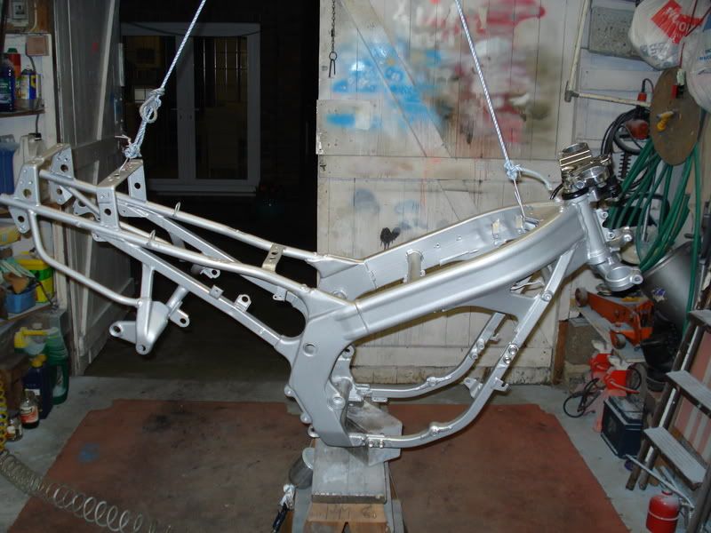

    The frame was stripped totally and given a repaint, the wheels were stripped by my son, rims polished and the centres repainted white. New bearings were fitted all round

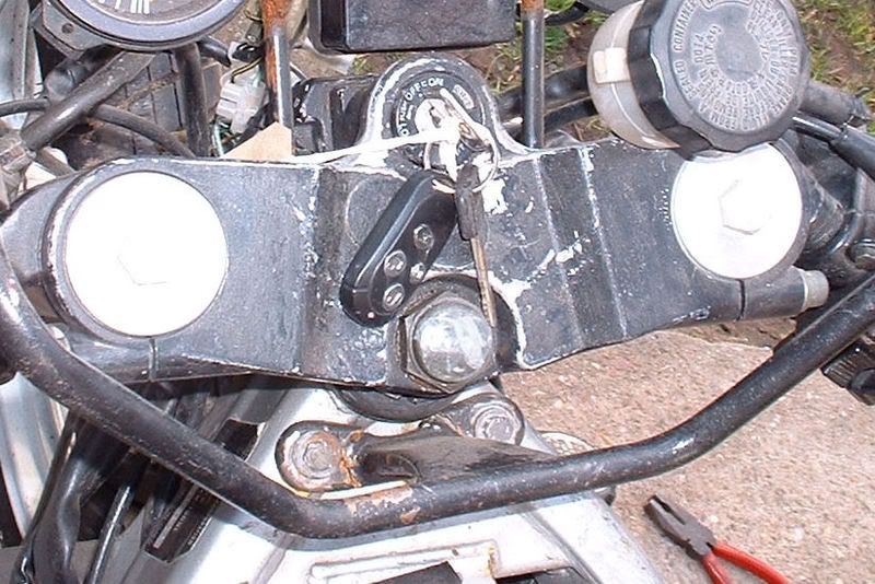

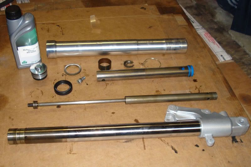

    The front and rear suspension was totally rebuilt and the top yolk refurbed
    yolk from this
    to this

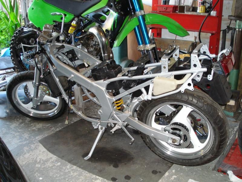

    Bodywork was repaired as necessary and primed ready for the base coat. The rolling chassis was reassembled and thats when things stopped (approx 4 years ago).
    The frame went to my parents out the way and panels went in the loft on the garage. Due to loads of building work at home I didnt have the time to do anything else with the bike at that time.

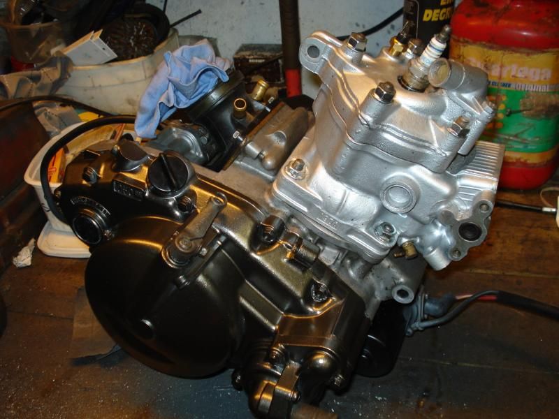

    I then stripped the engine and sent the barrel off to be resleeved, this took months as If you know Fahron Racing you'll also know Ron dont rush himself. When I eventually got it back 2 years ago it just got stored until this last winter.
    Being a bit bored one night after i'd finished the Zip SP rebuild to sell, I dragged out the RG engine and started to clean things up. I stuck alot of bits in the blast cabinet too and painted up many of the brackets etc ready for paint. I stripped and rebuilt the clocks as the surround housing had been broken at some point.

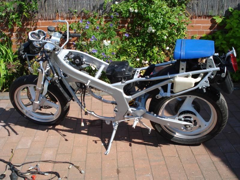

    Then approx a month back after the KX125 had been reassembled, i fetched the rolling chassis home
    Being as the weather was nice a few weeks back I started to paint up some of the parts that had been blasted previously. Neighbours wondered what the hell was going on with all these bits of metal hanging from the washing line (best time to paint when its warm and dry as the paint spreads well)

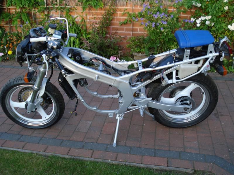

    Last weekend I started adding bits to the frame to see if anything was missing or needing attention

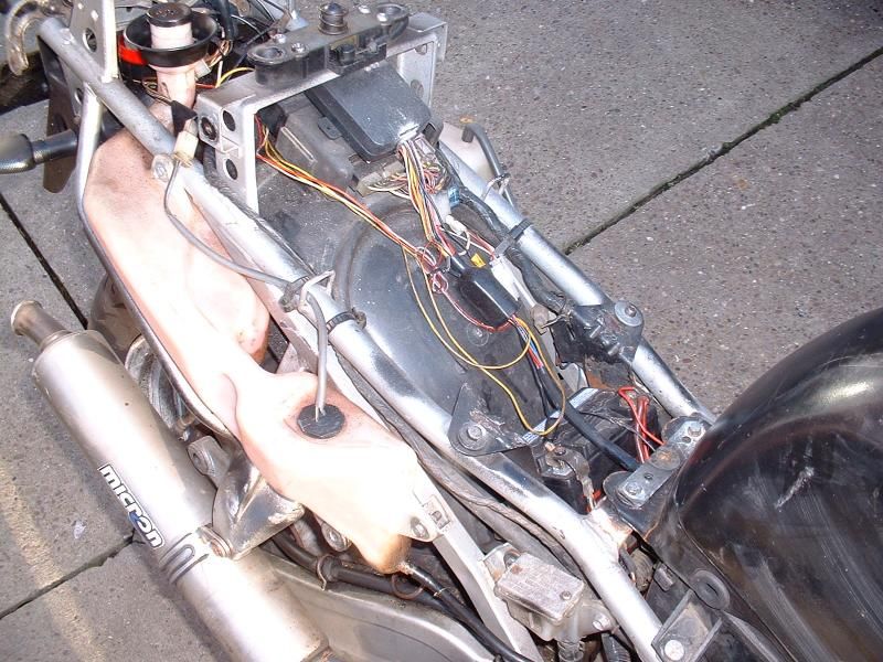

    The wiring loom was toast
    I bought another damaged spare so Sunday made one good loom from the 2 bad ones. All joints were checked, breaks resoldered and heat shrunk and all original fittings reinstated as they should be. I've now installed the loom on the bike and started to connect things up. next is to sort the switch gear and install it

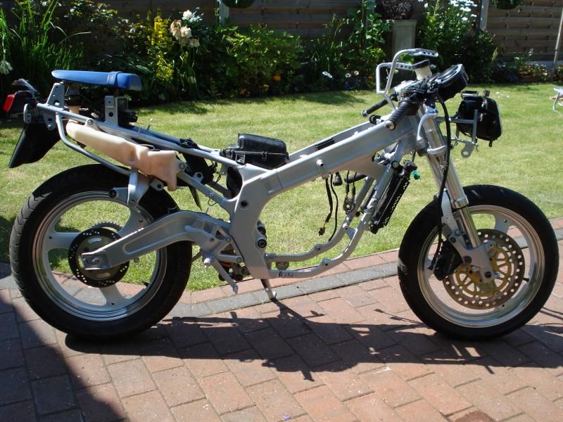

    Wiring loom now fitted with a few other bits. Some items are dry fitted to see if everythings there and lines up. Rear suspension has yet to come out and engine fitted now its done. Intend to place lump at side of frame, connect all wiring and power up system to check its all working right before I commit to the full install.Brakes are just placed on loose as i've got stainless hoses to fit

    dumped the lump at the side of the frame and connected this up. Hooked up a battery jump pack and turned the key....nothing :confused:
    So... started pressing a few buttons, first headlight pass button...light flashed! woo hoo, thats a start!
    So turned on lights, both high and low beam work (forgot to look at the rear :oops: ) Brake light switches aren't on the bike yet so no hope of them working!. Side light dont work so will check the bulb first
    Next, indicators ...all work as they should. None of the idiot lights work on the dash so thats have to come apart again, firstly to check the bulbs and then the wires. The speedo and rev counter both light up but again it looks like the bulbs gone in the temp gauge. Horn works too
    Next, just a very small press of the starter...just enough to move the crank...check
    Only a single wire remains that until tonight I dint know what it was....looks to be the neutral light. So hopefully what I connect it all up again I may even have some more idiot lights working on the dash...we'll see
