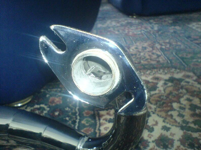

    also do u know where the restrictor on my technigas exhaust wud be ive looked down the bit were it connects tot the cylinder but cant see anythin.

    On my leovince it was at the very start of the exhaust. A cone tacked on the 1 side. A dremel took care of this.
    I also make sure it was completey smooth by removing all the tack and running the dremel round the inside
