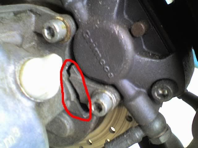

    The part on my transmission case which holds my rear brake calliper has snapped, making the calliper pretty loose. Is there anyway to fill or repair the scratch?
    This is a picture of the crack- if i undo the caliper bolts, the crack will get small when i push the two pieces of metal together...

    as a wise gingerbread man once said, youre up chocolate creek without a popsicle stick, it may be possible to get it welded but its not advised, the best course of action would be a new left hand crankcase. i'm sure there is somthing that can be done though.

    Will i have to buy a complete new transmission case aswell? Or can i just buy the part that i've snapped?
  4. wobbly_trials
    its the complete left side of the engine, will ask around to see if anyone can repair it.

    Two words:
    Drum Brake
    :nerd:
    Much much cheaper...
  6. MiNoR cOnFuSiOn
    thats a split not a crack m8.. and as said befor have it welded by a PROFESSIONAL tig welder.. have them make a plate to go over the top and seam weld this in place too.. looking around 60 quid for the repair with the plate

    If i were you i'd be looking for crankcases (good excuse to do your mains)

    Can they repair bolt holes aswell? The hole that the bolt goes into has now cracked, leaving just the bottom half of the hole

    Nope, my mum revved it whilst i was adjusting idle, and the calliper got caught, forced the bolt to snap the hole
  12. MiNoR cOnFuSiOn
    speak to a welder about it. it can be done, its wether somone neer you can do it. deffo plate the front tho as weld is never as strong as metal.. especially ali
