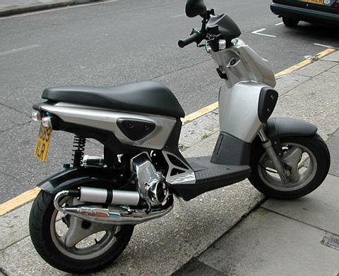

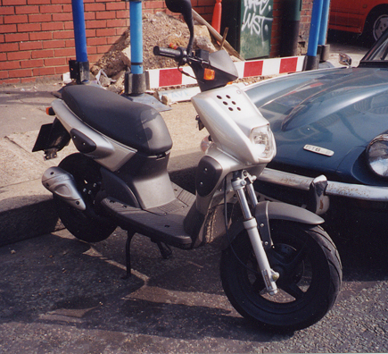

Here are a couple of pics of the Slider as it was. First is stage one mods described above so pretty much stock except for the Leo Vince exhaust. Second one is with the Polini For Race pipe, Neos wheels (I forgot I had Neos 12" before the rockets) and a few minor cosmetic changes. I think I must have a rise on the shock as it looks higher too but its so long ago now I can't remember.

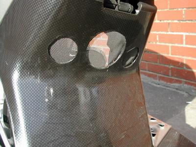

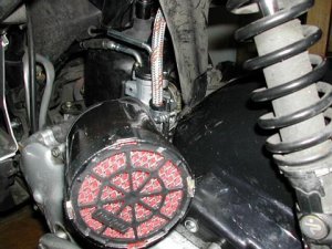

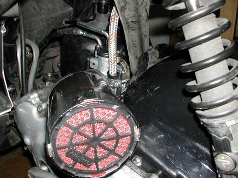

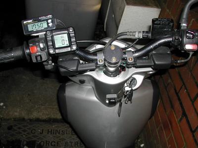

I just went on to the Zuma/Bws Yahoo Group forum I used to moderate on back in the day and pulled off some more photos This was the Naked set up I had wen I took off the instrument cluster. The square one was MBK OEM part from the Naked, shipped over from France and above it was a tacho from Scooter Attack This was the Doppler filter on the 21mm Dellorto. It was the best filter for my set-up but was too heavy for the jubille clip supplied to hold it on so had to be reinforced. Some extra air I created to cool the engine down as it tended to overheat even thos I fitted a modified air scoop. The carbon fibre look sheeting came from scooter attack and shrunk to fit with a hot air gun
