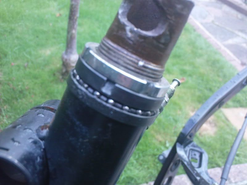

  6. WOLFFY
    What slot do I put it in?
    I got a pic.
  7. connor
    connor Active Member
    2,691
    the top one on the silver ring. take that off then do the same to the bottom one.
  8. one7twoboi
    one7twoboi New Member
    2,142
    Hammer and screwdriver will do the job ;)
  9. 2stroke-power
    2stroke-power Active Member
    1,061
    on 1-wheel
    yt
    u are missing a part in the middle ov the 2 locking thing that u hammer tight there and thing that sit in the middle
  10. DYS VTR
    DYS VTR New Member
    1,757
    skanky cRaKwhoR3s
    ye just use a large flat head and a rbber mallet on the 2 castle rings
  11. WOLFFY
    As soon as I put the picture up I realised what I had to do LOL.
    Used a chisel and hammer.
    They iz all swapped ova init bruv. juz gotta get soem marozzi stikerz

    what a c-spanner? thats what you use for head race's lol. no need for a special tool a c-spanner is the right tool.
    nah there 50 forks, which dont have the middle washer thingy, 125 forks do tho.
