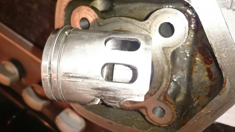

    I'll attach pictures if you are interested :)
  3. scubabiker
    i like carbon reeds, if that happened with steel ones the cylinder would need replacing, sometimes ive seen them take out the crank bearings too....

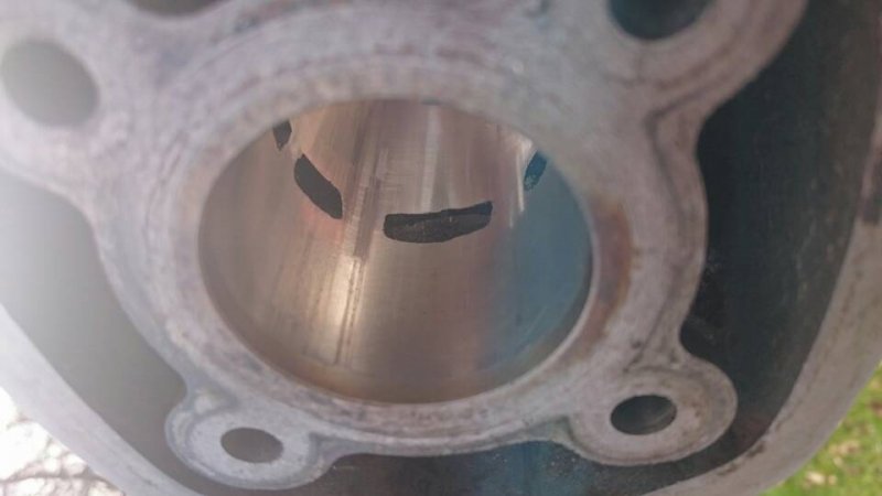

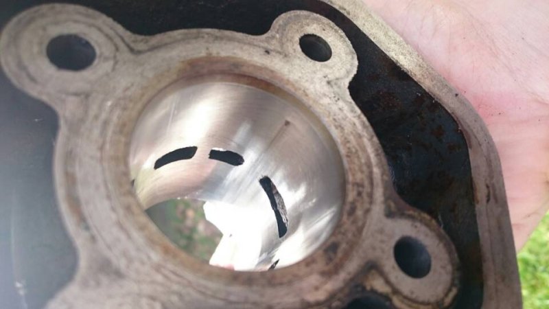

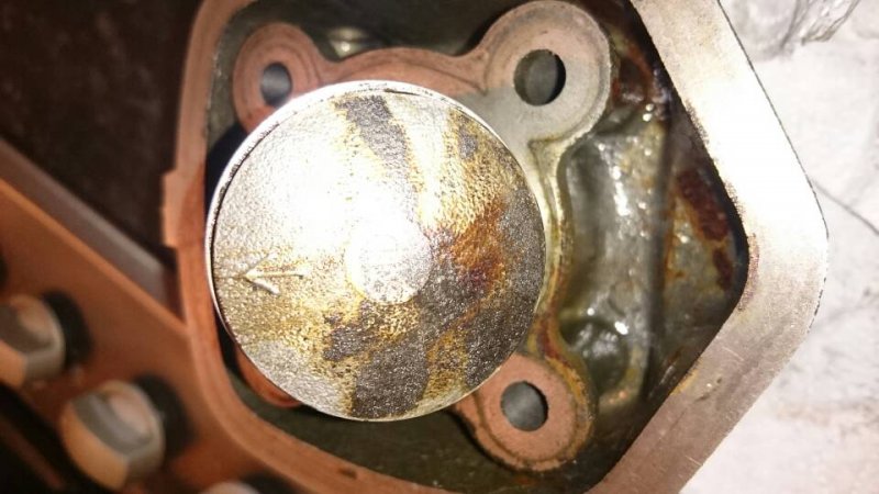

    This all seems a bit odd to me, have a look at the pictures.

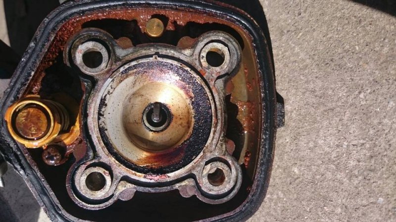

    Judging the combustiom chamber, it looks to me as the head gasket went too ? Ive been looking at the images myself.
    Also would this explain the banging or popping sounds i heard before it siezed ?

  8. scubabiker
    looks like its got too hot to me, see the way the scoring is near the studs? you see that in bikes that get ridden hard before the warm up, often is on all 4 studs, called a 4 point score, happens of the coolant mix is wrong too which looks like yours is, judging by the rust, but also looks like the reeds did some of the damage.....

  10. scubabiker
    did it maybe leak? does look a little like the head gasket went. never seen one thats got so many possible faults like that before!
  11. scubabiker
    if the head gasket went it would have blasted coolant out your header tank and smoked white smoke.

  13. SliderTom
    SliderTom Member
    88
    Yamaha slider
    And when i allowed it to cool i noticed white smoke pouring out the exhaust, but at the time of morning it was, my mind was all over the place, being 0400hrs and commuting to work, you dont expect it.
  14. SliderTom
    SliderTom Member
    88
    Yamaha slider
    Looking back scubabiker. You might have hit the nail on the head.
