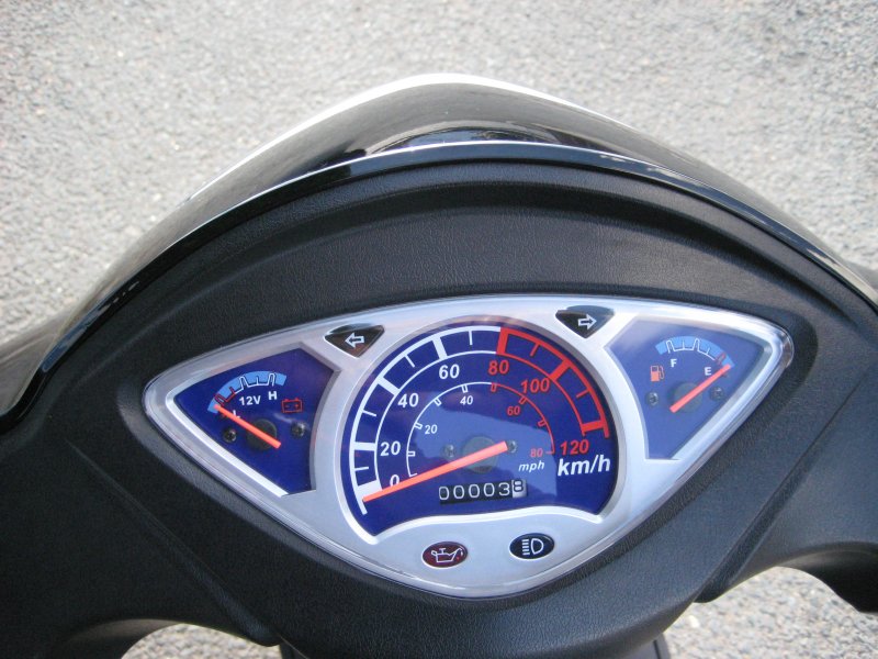

    After years of 2 stroke motorbikes I decided to buy myself a 125cc moped.last week I purchased a 2 year old nipponia 125 miro.it is air cooled and I was wondering if it will be good for a 72 mile round trip.obviously on this trip at some point you will be in the red line to get top end speed,is this a bad thing for the moped and will it cause damage to the engine etc

    Theres no "obviously hit the red line" you are in control of the bike so find a cruising speed and keep it under the red line and the bike will do fine on a trip like that, if you don't then it won't.

    My cruising speed will be 50mph then has after that I'll be hitting the red line

    Then 50 is high as you can safely go.

    i would say its fine, i used to take my old runner VX at full throttle runs for easy 50 mins (down the A14) as long as you keep your bike serviced well it should be fine, they have a rev limit built into the ignition to stop over revving and valve float, nearly all bikes do in fact.
