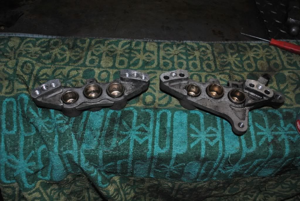

    Thought i'd take a few pics as i was doing this today.

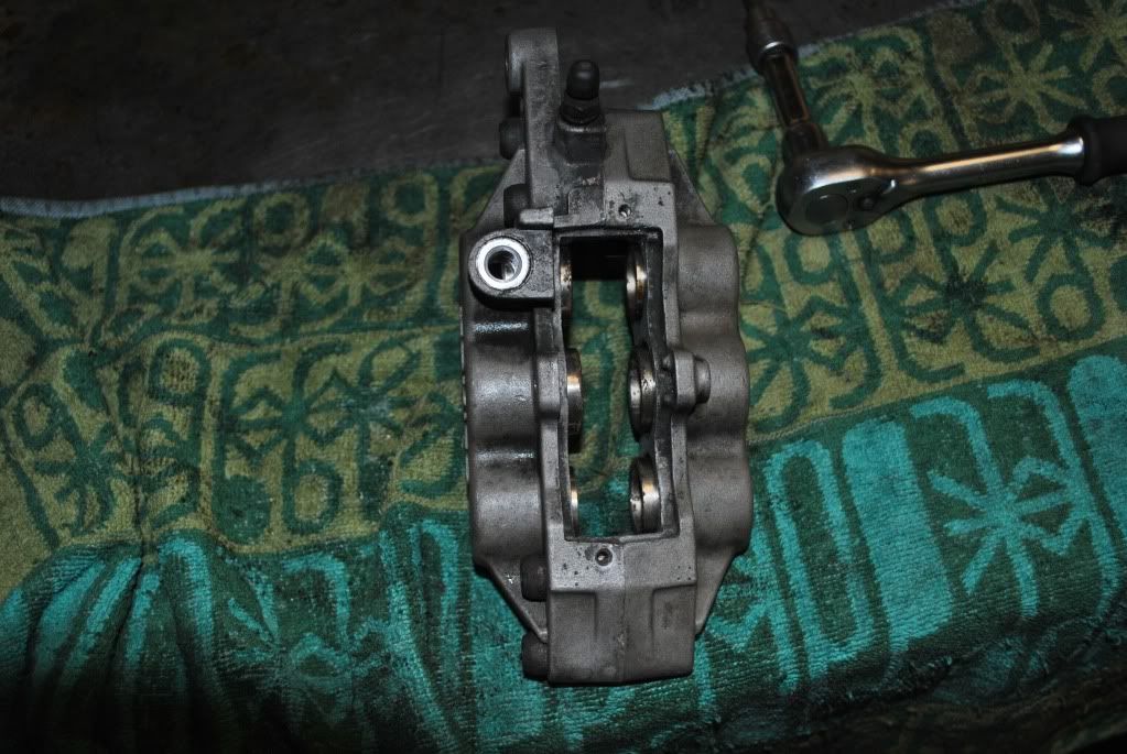

    Removed the caliper from bike
    split the two sides
    took the pistons out

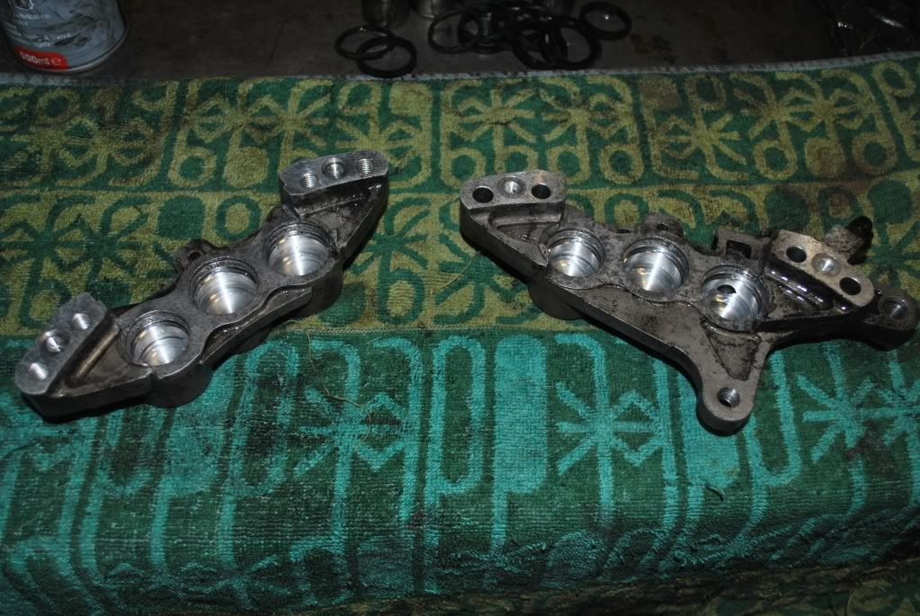

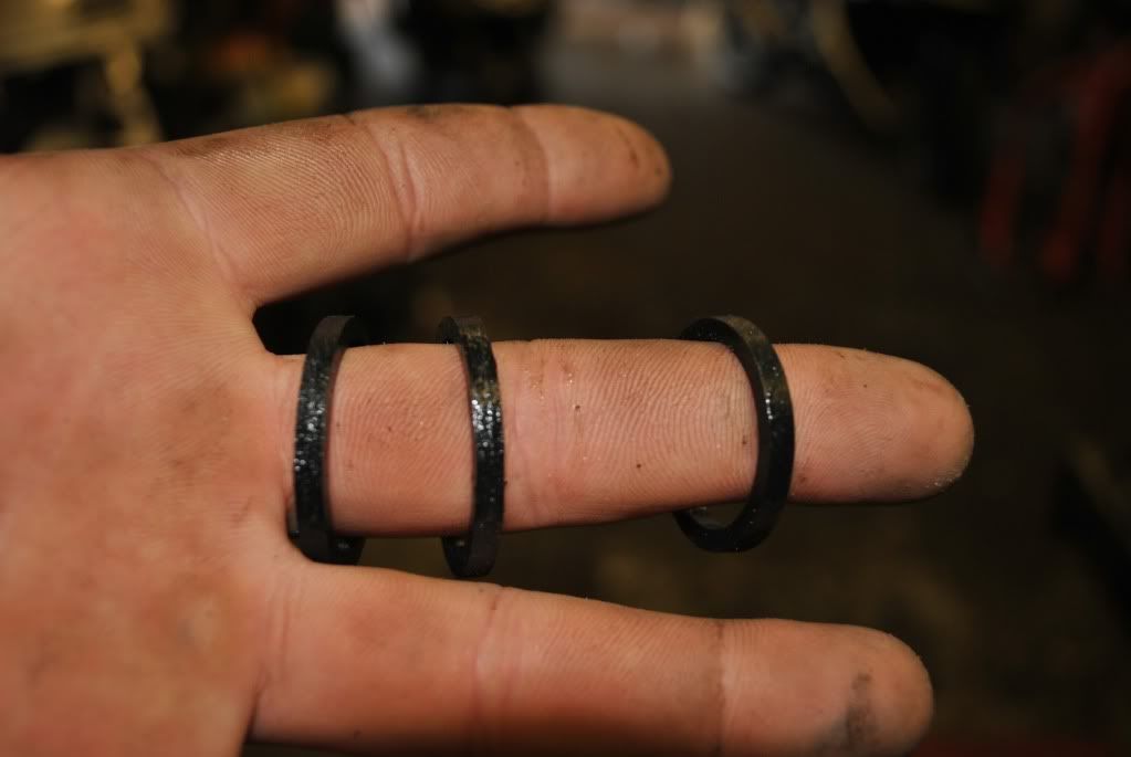

    Removed the seals

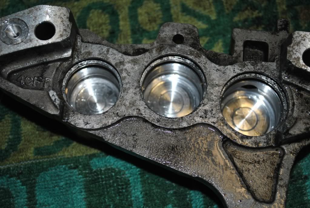

    Cleaned the recesses in wich the seals sit (i use a small 90 degree angle pick) with some brake cleaner and blew all the corroded crap out of the pots with compresses air.Checked all the whole thing was nice and clean inside.
