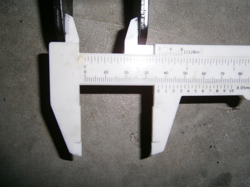

Hey guys. Just an update to this. I ended up buying the fancy BGM one from scootercenter. I confirmed with them prior to buying it that it would fit on the 180 without modification. They were wrong. The rear bush required about 3mm taken off it to fit. See photos below showing width compared to standard shock. There is a bigger problem than this though. The BGM shock has a much longer mounting stem at the top than the standard shock. This means that it cannot be fitted using the standard rubber bushes - see photos below. As you can see above, when the washer is placed on the top it will leave over 1cm of movement against the frame. The only thing that I can see would avoid this from happening is if there was a much thicker rubber bush underneath to raise the frame up, but the BGM shock didn't come with any mounting hardware at all - only the shock. Can anyone give me advice on how I should mount this? It is certainly not a simple replacement for the standard one.
