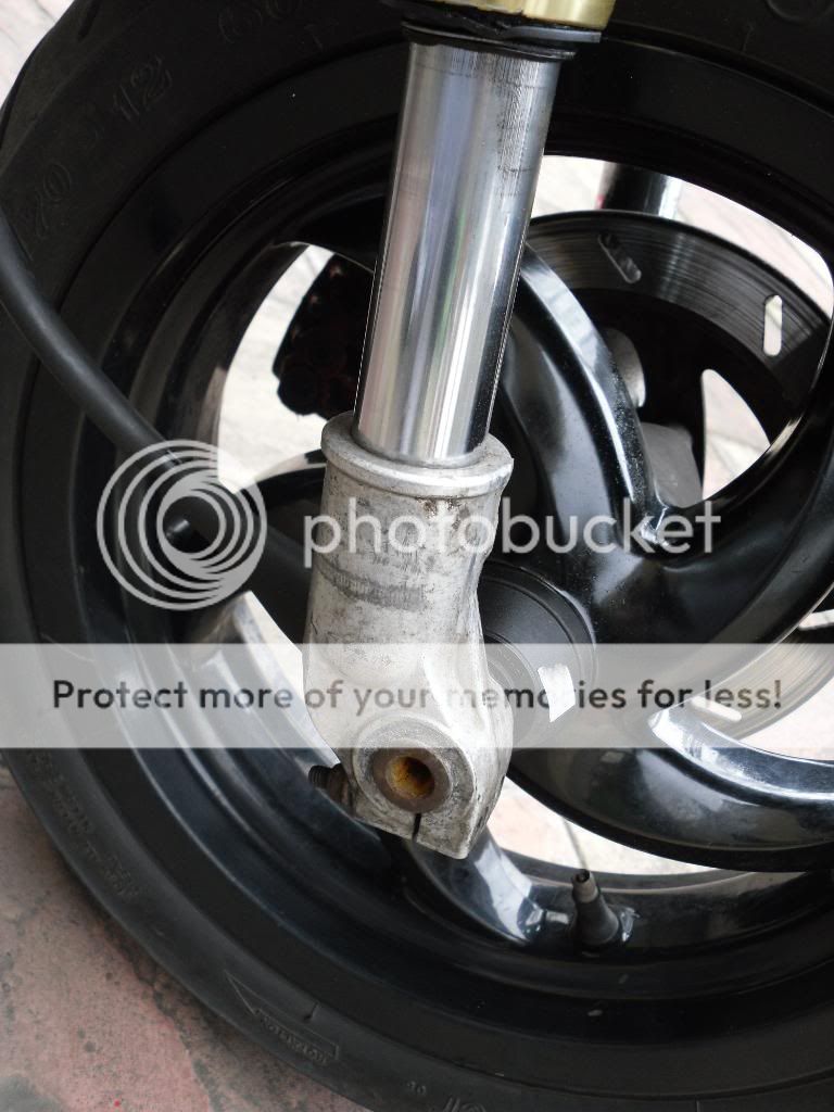

    Basically taking my bike for MOT soon. Its a Gilera Runner SP50.

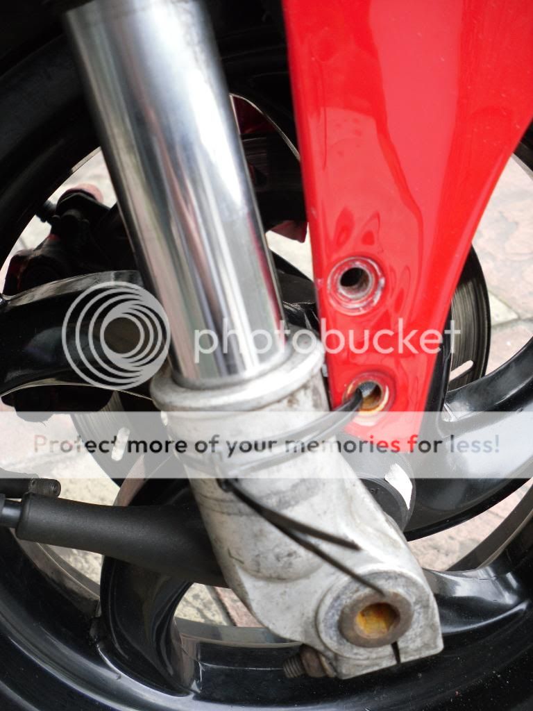

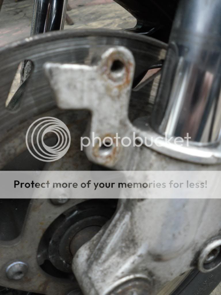

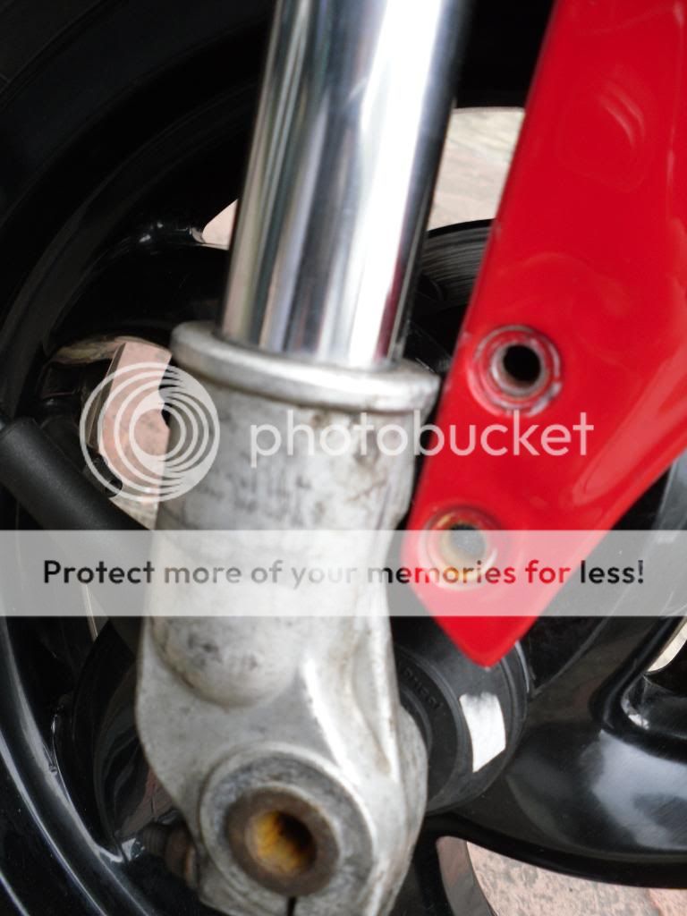

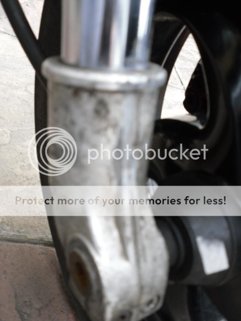

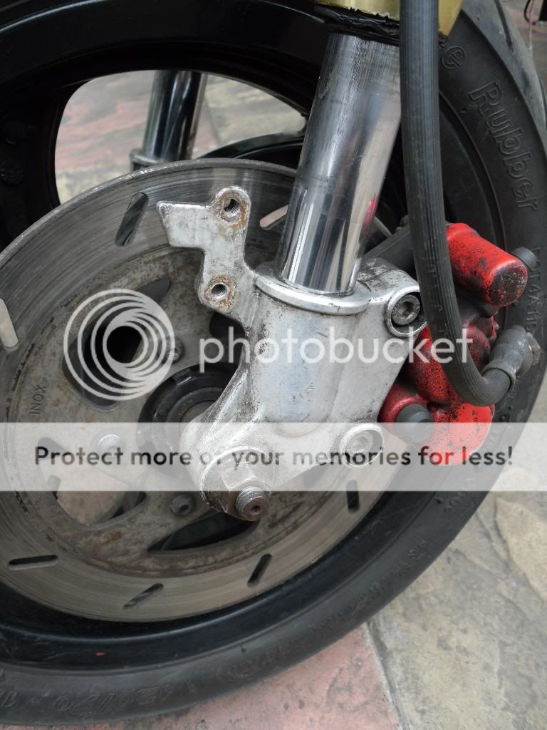

    Need some advice about the forks i have on them at the moment, as on the R/H side the lug snapped off so im currently holding the mudguard in with CABLE TIES :confused:cratch: but the L/H side is good to go.
    Tell me what you think. Cheers

    wont pass a proper LEGAL mot with it liek that. there 125 forks also..

    Mot it without the mudguard, should pass without I've done it before.
  5. tErr0
    You should go to a different mot place then. Shouldn't pass without a front muddy on pretty much all scooters apart from a typhoon.

    Can use a universal headlight bracket for a streetfighter as long as it's the correct I/D. Or just get a local welder to weld a lug on,must be cheaper and less hassel than buying and fitting another set of forks,that's if you can find a decent pair.

    you know mick before you said this ive never questioned makign up a bracket similar to the ones on malossi forks :lol: nice idea im sure it will save a few penies somewhere along the line :thumbsup: :thumbsup:
  9. m1ck_t
    Personal experiance lol, can't even say it's bodge as it works a treat, certanly better than the hopeless lugs the stock forks come with

    i dont know where the lug is lmao i bought the bike like that o_O

    did you not get any runner 50 forks with it then
    i would say thats ok as it is but get a few more cable ties so the mudguard doesnt drop on to the wheel

    nah i bought the bike like that just noticed it when i was fitting the speedo drive on. i hope it passes a mot with cable ties though..
