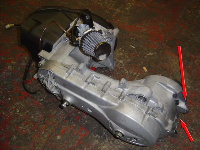

    hi would a aprilia sr125 engine from 1999 have disk brakes mounting on it?
    thanks
  2. tweak
    tweak Member
    652
    Yes
    1999 motor...

    abz Member
    606
    Am pretty sure all sr125 have calliper mounts
  7. SR-STEF
    SR-STEF New Member
    811
    my engine is a 02 and has mounts
  8. wobbly_trials
    both my '97 and '99 do.

  10. wobbly_trials
    looking at silly money for those mate, best bet is somone breaking a runner
    you need wheel, disc, caliper, hose and master cylinder, then you need the mount drilling and tapping.
