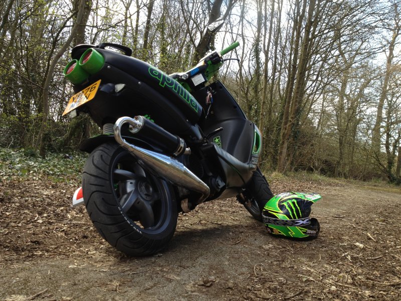

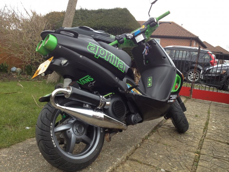

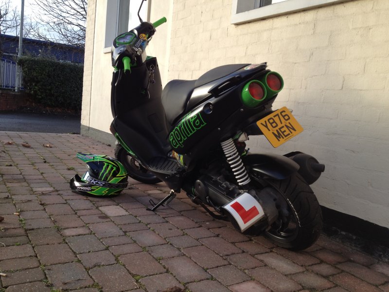

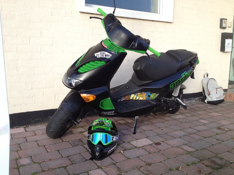

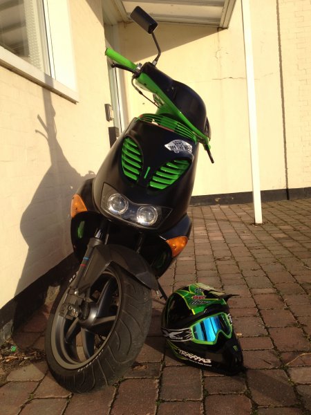

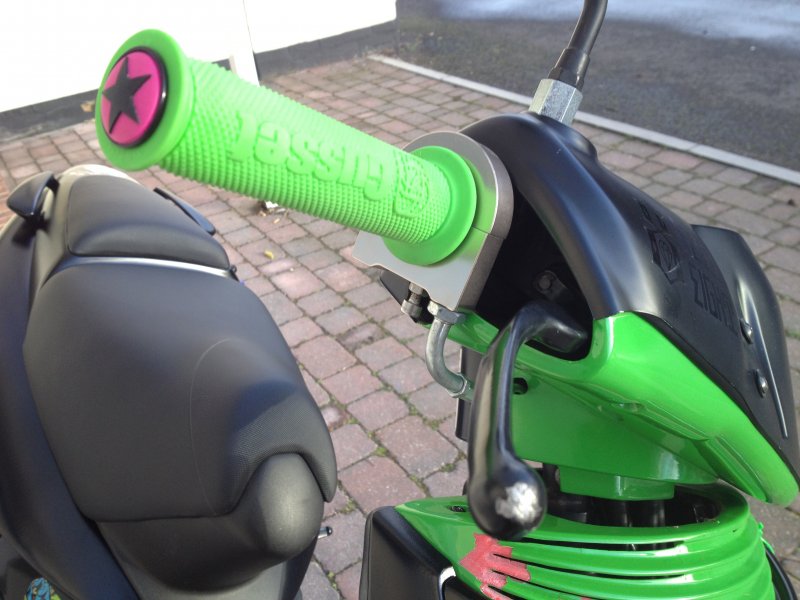

    done a few more bits to the sr getting it ready for the summer :D
    fitted new...
    quick action race throttle & throttle cable
    green fuel line
    fuel cut off switch
    ngk spark plug
    stage6 jets
    pedmoto air filter
    green gusset grips
    sticker bombed inserts
    engine clean up
    next stage handle bar conversion and exhaust i think :p

    Nice scooter, not normally a fan of sticker bombing but thats nicely done and not over the top :)

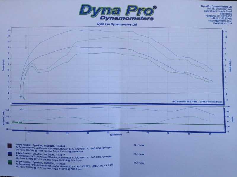

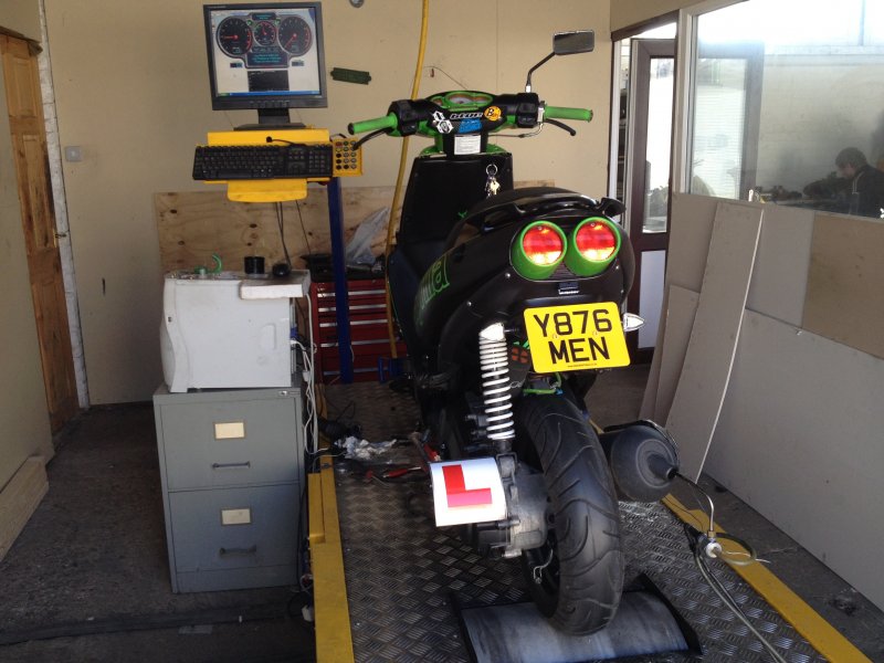

    had it on the dyno yesterday running spot on now and got my bhp up :D

    Dyno is about £60 for full set up I got it cheaper coz already set it up by hear so dint have to do much.
    About 65mph at the mo was doing more but got the Acceleration up much better hits 60 in no time now. I had a polini panel fitter be for my open filter n it done nothing really.
