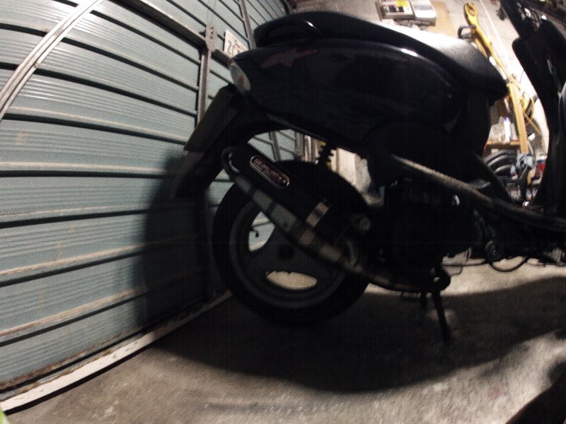

    yam neos 50/yam cw70
    hey guys i have checking out theys kits for my neos
    i have romove the varator restrictor and also the the exhaust has also been changed
    as well as changed the rolers and i am going to upjet when they arrive
    bu i was wondering wheather there any good
    becouse it feels like it could easly go up afew gears my engine dosent struggle at all
    and are they to difficult to fit ?
    all the best oli

    gear ups are for when you change from a 50 to a 70, the smallest gear up ratios designed for 70 cast iron sport kits and up, are around 20%, I doubt a 50 will have the guts to pull this. I f you do go for a primary, get a ready pressed one it will make life a lot easier and you can just swap the old with the new:)

    yeah its just my bike feels like it just runs out of gears really early and i want to keep it a 50cc

    would it still work thoue or would i lose acseleration ect

    At best it will gain about 3mph and take twice as long to get there. Get a 70 kit if you want to go fast tbh
