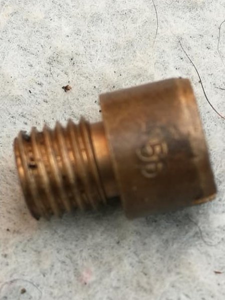

hi thanks for replys took the carb apart took out 2 jets small fat on said 56 on it and long thin one 48 is that ok or what should they be cheerd

i ordered a 60 66 70 jets this is the exhaust that is on the bike http://www.tecnigas.com/o/model.php?codi=46&cat=2&idioma=en
