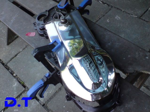

  6. kyle1b1
    lots of hard work helps too.
    my attempt

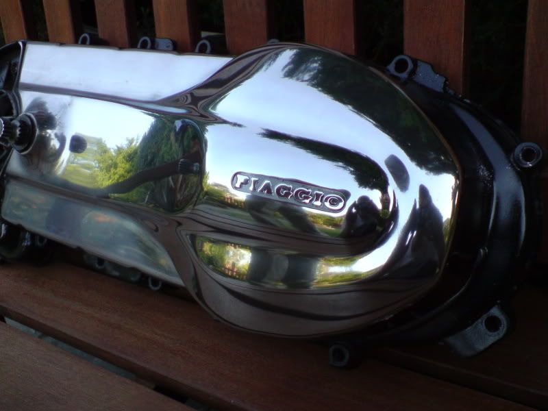

  7. Jefr0-180
    Mine:
    Don't think that it will get good quick, takes alot of time and attention to detail.

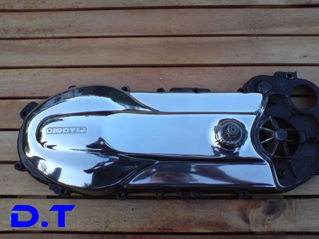

  11. alexsr70
    alexsr70 New Member
    2,039
    my attempt
    Nitro Morse
    Wire Brush
    120 - little tallow
    Scotchbrite Wheel
    240 - little tallow
    400 - little bit more tallow
    600 - fair bit of tallow
    800 - fair bit of tallow
    1200 - loadsa tallow
    1500 - loadsa tallow
    then hard mop (4000) - with black polish
    then soft mop (6000) - with white polish
    took me like 5 hours for this finish on first attempt, could definately knock it out in like 3-4 though

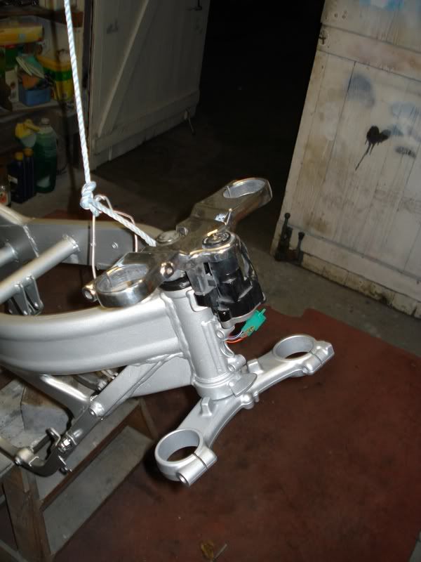

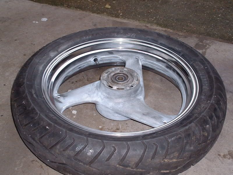

    Heres the wheels that my lad did for his RG125 that we're rebuilding
    [​IMG] and the top yolk
    Takes time & plenty of patience making sure youve removed the scratches from the previous layer or wet n dry grade. BTW always polish accross the lines or marks left by the previous grade. Going the same way will only make them deeper
