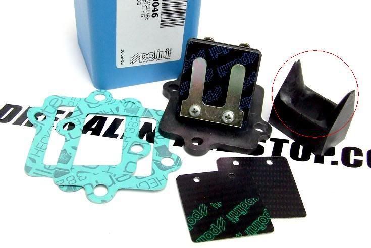

    whats tht piece of plastic circled in red used for. my old standard reedblock didnt have and im wondering why my polini reedblock kit does?
    does it run faster without it or sumthin?? :wtf:
  2. wobbly_trials
    looks like a restriction to me, unless it matches your manifold, then it'll help smooth the gas flow.

    yeh i got one with mine mhr-rep block goes inside the block and retricts it. leave it out :punk:

    its not a restrictor its a stuffer!!! ;)
    according to the instructions you only use it with the polini manifold...
    minor...if you read this....do you use the stuffers or not??? :D
  6. wobbly_trials
    i'vea heard of these, it's to keep velocity up in the reedblock, i've never actually seen one in the flesh though.

    if your running a stock manifold u need to keep it in,
    without it in u lose velocity like wobbly said, the atomised fuel does'nt have a direct path into the reedvalve does it . its allowed to go whereever in the reedvalve when it reaches the exit of the manifold.
  12. MiNoR cOnFuSiOn
    i run them half an half depending on manifold.. if you use the straight manifold the exit hole is round thus matches this an keeps velocity up as stevo said.. also makes the entire inlet tract match. the stock manifold and reedblock are a perfect match tho BUT the area of the manifold is actually larger than the carb so any velocity based compression that was gained in the carb will be lost in the manifold.. this is what it corrects. use of a bigger carb or straight manifold matched to a square hole is the best option in most cases but some bikes (like abz's zip) ran this and wer verry fast. its NOT A RESTRICTION
    more volume of a less compressed gas is a waste of power. somtimes less actual volume of combustable mix in a compressed form is better.
    so ye your all still in the dark as to wether to use it or not but you know why you should/shouldent now so try it out for yourselves

    ok minor...it said in the instructions to only use the stuffer if the polini (angled) manifold was being used..
    and not to use the stuffer in the std (piaggio) manifold...so i never bothered useing mine :D
  14. MiNoR cOnFuSiOn
    yup, the "angled" one is straight if you think about it.. stock is angled the straight is at a "pitch" where the carb will work
