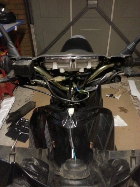

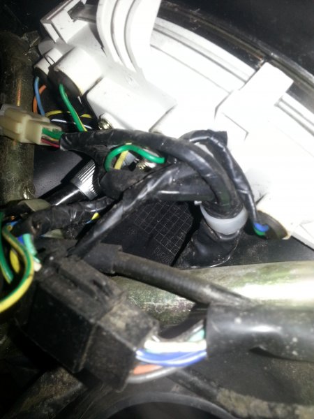

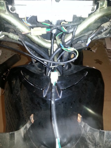

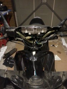

    Can you take some photos tomorrow in daylight and let's see if we can spot anything obvious? The wiring connectors will be sort of square and have pins inside. They make then different sizes and shapes so you can't get them mixed up.
  17. Donna
    Donna New Member
    28
    yeah of course i can, i'll try and take some tonight as got a garage and has pretty good lighting
  18. Donna
    Donna New Member
    28
    ive taken som pics but cant upload them on here for some reason how can i get them to you?
