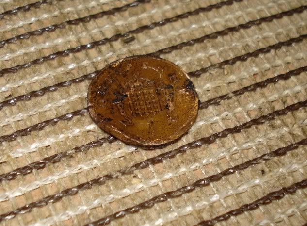

    the studs were already removed, got it out though, forced it and he had to get a new barrel and piston, now hes encountered another problem, theres a piece of metal stopping the crank spin freely, its stuck between the big circle of the crank and the casing, either that or the crank is bent, if it is a piece of metal, is there any way to remove it without splitting the engine casing? weve tried pushing the metal out with a feeler gauge and spraying oil down the gap. If he cant sort it then hes giving up on mopeds altogether :(

    Try one of those strong magnets to see if it'll pull free..
    or tip the engine upside down to see if it'll fall out
    When I bought my lads ZipSP it had both a 50cc and polini 70 barrel with it...both were off the bike and scored but
    the crank wouldn't rotate so we split the cases
    heres why it wouldn't move
    it was wedged between the conrod and crank webs :whistle:
