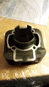

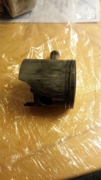

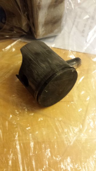

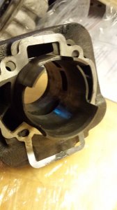

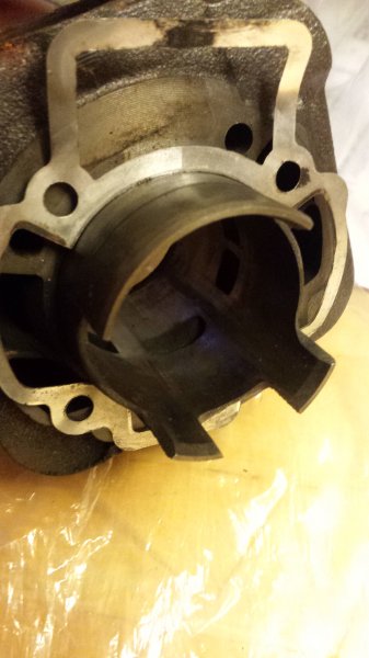

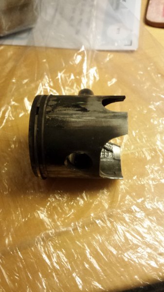

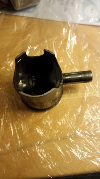

    I was given a Piaggio NRG Power DT and after 100 metres it died. A new cylinder kit was installed and it ran great, started first time, would easily get to 45 before slowly increasing to 50 (max, although downhill it reached 56 and cold hold it there). 3000 miles later its died again. Would turn over as usual but it wasn't starting. It died after a sudden high pitched whine going 40 . Removed the cylinder head, cylinder and piston and will attach some photos. They aren't the best quality but if necessary I can find them on the camera and put them on.
    The scoring on the piston suggests (according to the manual we have) that the scoot is running too hot? The piston rings are stuck, and as you can see there is metal or something against the cylinder head.
    I hope you guys know what is the issue as we don't want to take it back to the repair shop (although they are reputable and nice guys).

    looks like it was not set up correct.
    very black on the piston top and head for a new kit, wouldnt expect that sort of coke build up so soon. signs of blowback on the piston skirt where rings failed, were lucky not to have a full sieze. were both gudeon clips in the piston when you removed it ? maybe ones been thrown out due to not being seated correctly.
    i would say autolube was not correctly adjusted and gave enough lube for the new kit and has just let the temp raise to much for the rings and piston to cope with.
    Another point is that bottom gasket is the incorrect one for the kit you have to images 6-7 show a large extra port section in the gasket wher ethe cylinder does not have it. any mech would have known its the incorrect gasket.

    Both clips were in the piston, but the rod or whatever (thing sticking out of the piston in the pictures) was very hard to remove that much (I guess the heat caused it to expand or something?).
    About the gasket that was something we noticed. The gasket looked fine against what the cylinder bolted on too, but against the cylinder it doesn't match up.

  4. scubabiker
    thats a 4 point score, very typical in engine that have ran too hot, usually because they are ridden too hard from cold, or lack of coolant, that being an AC kit i would say the former. its a little sooty looking but not too lean....
    so next time let it warm up before you ride it hard

  6. Stevep
    That looks like a 70 kit?
    Should run a little extra oil in the tank as the standard pump output isn't really enough for a good lube if it is.
    But to have that much soot that far down the piston indicates that the bore is somewhat oval, probably on the exhaust side

    That's a new kit and looks like that?. Feel sorry for that kit man. That's the problem with 70s. People install them like they would with a 50, use to many gaskets with the wrong squash clearance , not enough oil, reving the shit out of it when cold like he said above, not running the kit in properly. Personally for new kit you shouldn't even be going 40 50 at all...say good bye to that kit :( god knows what you done to that poor Polini .

    The walls of the bore look too thin to be a 50 kit, and the piston appears bigger, more 47mm than 40mm.
    But photos can tell lies
