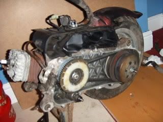

    Bought a zip 50 Air Cooled
    As you can see its a bit dirty but i'll soon get that sorted

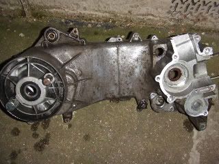

    Just Crank cases
    After Major hassle i finally got the wheel and kickstand off
    here it is after a bit of a wash.

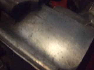

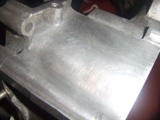

    Scrubbed it down and now started sanding
    Here it is at the start
    And here it is At the moment

  2. MiNoR cOnFuSiOn
    strip the plastic work off, block up any holes/the flywheel/variator shaft to protect the seals then scrub the fucker

    alot of you will be surpised when i say......
    polishing a crankcase makes it more likey to snap/crack.

  18. MiNoR cOnFuSiOn
    no, an untouched case is more likely to crack, casting defects and the like will be natural weak spots (like the main seam) a rough finnished case wont crack atall. (well, 99% aslong as theres no casting defects other than excess material wich has been removed) polished cases are more likely to crack due to the process of polishing/removing material. if done correctly its not any more likely to crack.. ether way a stock case will crack befor a preped/sanded and blasted case will. they all snap in the same places. its usually down to poor mantenance (brake lug's snap from poor clutch removal technique, exhaust mount lugs break from incorrectly repaird damaged threads/bent exhausts/incorrect exhaust mounts, engines snap on the tranny cover due to too tight bolts or not enough fo them, hitting speedhumps fast or over worn engine bushes)
