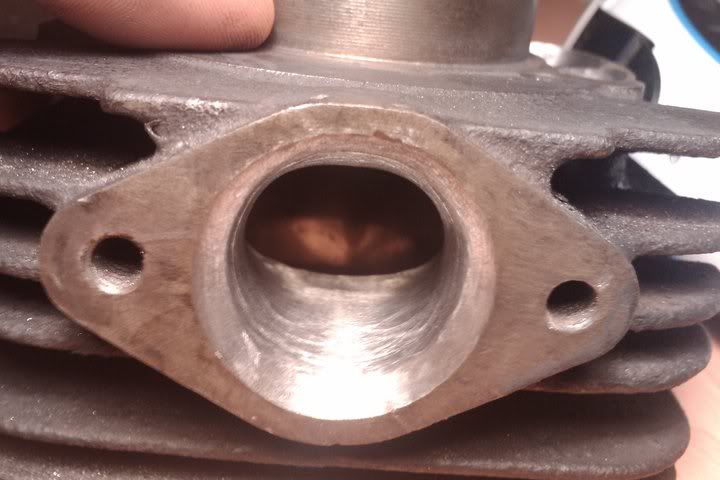

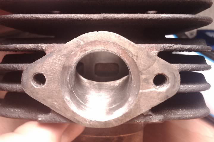

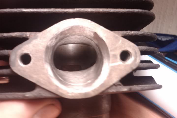

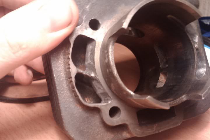

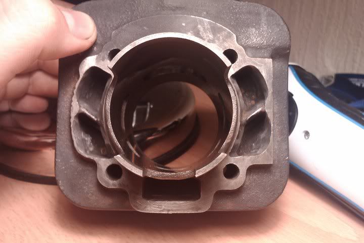

    Thank-you. Well I'm hoping to do bikes as my hobby and do I.t to fund it, So if I want to get the most out of small engines, Need to learn these. Thought it would be easier to learn this first than flowing :) Thanks for the help. I've got some Photo's of my first attempt on a kit I had lieing around which is totally buggerd, Can you tell me what you think ?
    Started With this after a clean up.
    Then progressed onto this. I think i've buggerd it up.I've not got round to final measurements.My Internal Micrometer has gone missing :banghead:
    I know i'm going to get told i'm fucking useless or I should never touch a moped again. But fuck it, Only way to learn in my opinion lol.
  9. MiNoR cOnFuSiOn
    got the right idea opening the port to match the olive fitting (the chamferd section surrounding the port) dont touch this tho as its what stock/shit exhausts matt up to. as youve done be sure to remove material ALL THE WAY back to the port face or theres no point doing it. if you wish to remove the olived exhaust and make the port as big as possible you can do just remember it wont run any stock type exhaust, you will need to use a flat stub pipe and match the port diameter to this... transfer feeds are a little messy but you have the right idea.. the middle's need to come out tho and you want to try and keep the shape as constant as possible.. again, fuck all point unless it matches the case its being fitted to (both in size AND angle of the matching faces)
    in whole.. you would see some gains from this, but not the gains you should see from the same ammount of work. needs finnishing off but for practice its not a bad attempt :)

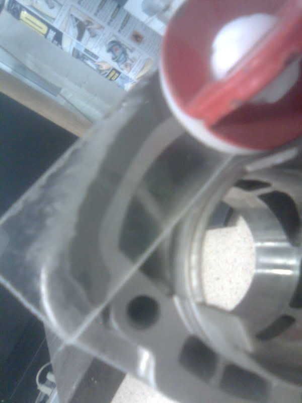

    easy way to make things a little wider on narrow kits like this is a peice of cling film, something flat (or a laminated peice of perspex as ive used....) clamp it in place. apply chemical metal, let it dry.. remove plastic and peel off the coating/cling film.... makes a silly thin kit not so silly thin.
    should get you something for the gasget to sit on :)
