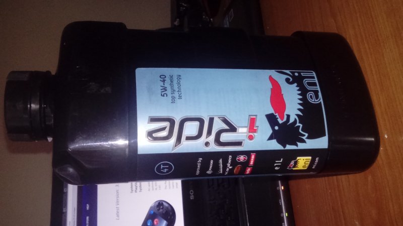

Hello, just pass 500 km after kit. I have to retighten engine head and check valve clearence. After that I will change the oil
