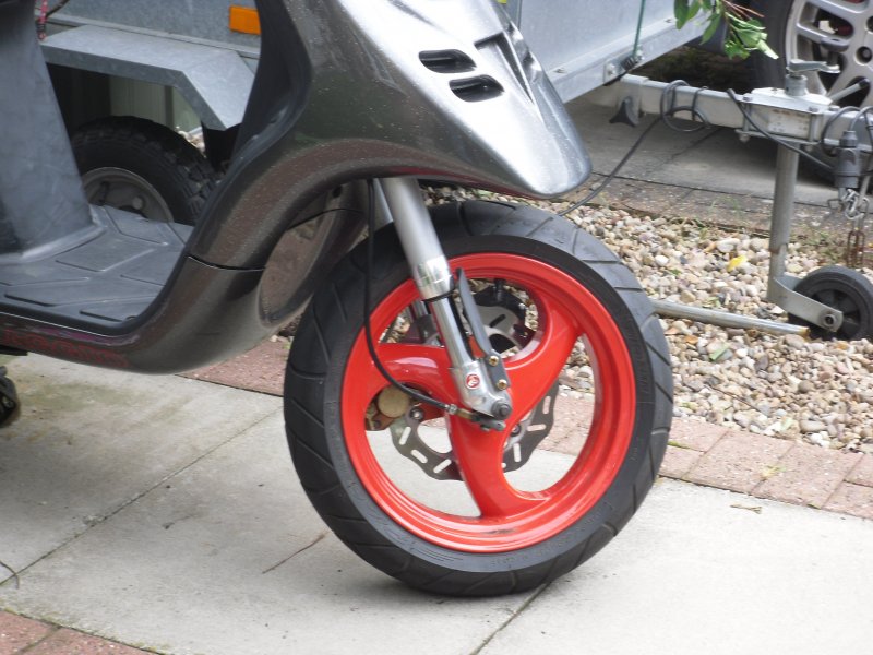

    hi i have a piaggio typhoon 50 with nrg wheels and forks teh problem im having is ive got the right speedo cable but i can not work out what speedo drive i need to get an nrg one or a typhoon one any help would be much appreciated

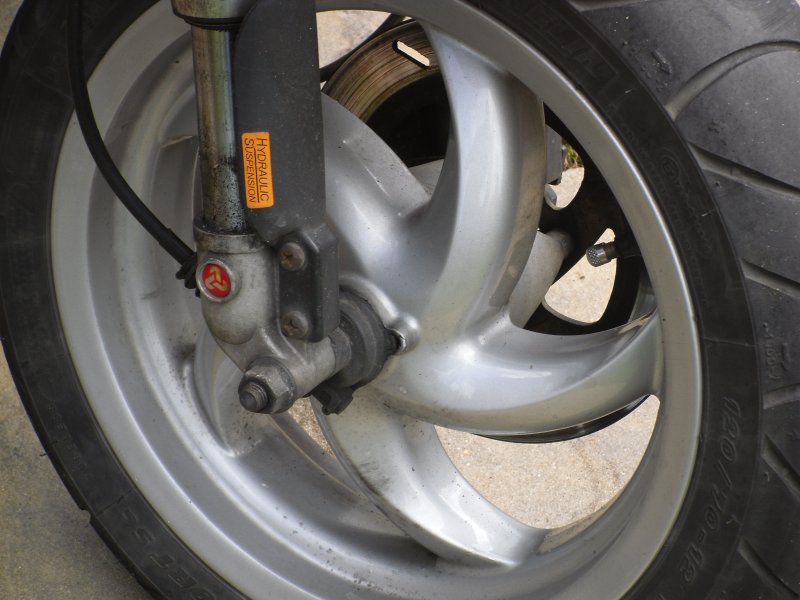

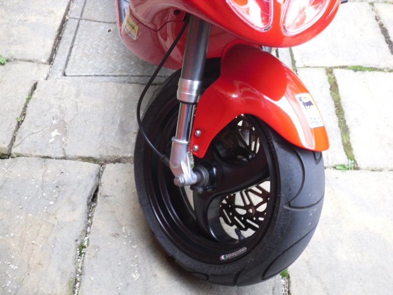

    A direct replacement for the original 10" wheel is a Mc 2, (NOT Mc3) nrg wheel, 13" 3 bolt disc fitting and correct typhoon speedo drive and disc size. They are very hard to find in the uk but try ebay france, there's load's of them, search for NRG/typhoon or storm, just ask if they will send to UK? Here's two 13" front wheels on two my typhoons, my other typhoon uses a 12" front wheel. SDC11722.JPG SDC11731.JPG SDC11722.JPG SDC11740.JPG The only thing you need to do is space out the brake caliper a little.
