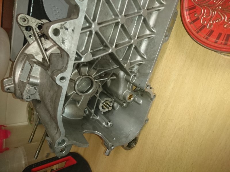

I think the cranck case is open a little and i am leaking oil and whatnot from under the stand area i think it has a leak in the engine case and im gettin bad compression
I qm going to re build the hole damn thing and if that dont work what do you think because i am getting new seals a new crank

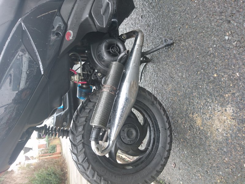

Ok well the bike is now working. i put a new naruku carb with a metal air filter with plastic cover ,a new Airsal T6 70cc bore kit, put on a replica stage six exhaust now the bike works good but but its kinda slow on acceleration i know the new shape typhoons are really heavy but i expected more from it the clutch has stiff springs and the variator is standard with stage six rollers 7.5grams what are you're thoughts mate
Uno what i think the main jet was too big its better now it had a 92 mm now it has a 85 much better respons thanks for the help
