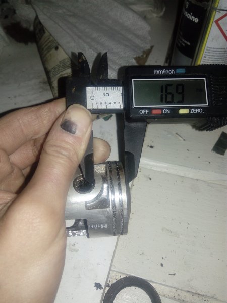

Well i tried 3 different carbs all set up to 70cc bikes i was thinking its the piston everything is good condition other than that so about the piston do malossi a/c piston work in a motoforce a/c kit because i cant find any motoforce pistons online lol
Errr I wouldn't know. If the bore size is right it will fit, but the crown to pin might be different, the skirt too. See if you can get some measurements before you buy one.
