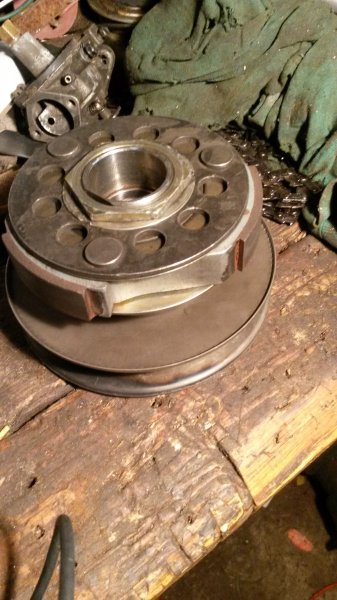

    I took some pictures of the clutches/variator.

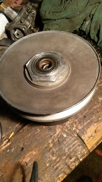

  3. m1ck_t
    The back of your clutch is weird , never seen a nut on the back ? Have you fully stripped out the clutch and the rear pulleys , took the pins out and split the 2 apart ? Regresse them with either light LM or hub grease.
    You're correct about the plating wearing off on the front pulley/variantor and it would cause a slight judder but only ever so slight .

    It's an original Piaggio clutch as far as I can tell, but may be originally from a slightly different model. That nut just let's you remove the rear face.
    I did have it all apart, and had the pins out, multiple times. Seems to work good for a while, then sticks again. Almost seems like it sticks more when hot, maybe I used the wrong grease.

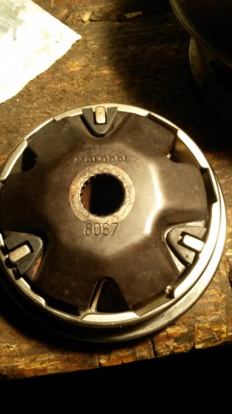

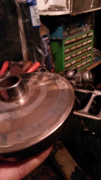

    Here's pictures of the shims, and the front pulley/variator, in case someone spots something I may have missed.
  8. Stevep
    LOOK AT THE DAMAGE ON THE REAR OF THE CLUTCH PULLEY!!!!:eek:
    Small wonder you have vibration. That's shagged.
    I can see the gap around the bearing from here.
    I've never seen a clutch rear like it.
    Think you'd best find a new/replacement one double quick, and chuck that one in the nearest bin.

    That picture angle makes it look look way worse. The gap you see is the flat spots on the threaded portion on the end of the pulley, the rear pulley face is held on by a nut. Bearing sits in there tight. If you look up in the post you'll see a better pic of the backside of the rear pulley, only difference now is that I changed the bearings in the pulley since then.

    Here's a better picture of the backside of the rear pulley. As you can see the bearing sits in there fine.
    I still don't know where to go with the vibration issue. Maybe it's not even a belt issue, but something else completely different, but I don't know what else would cause it to suddenly snap out of the vibration.
