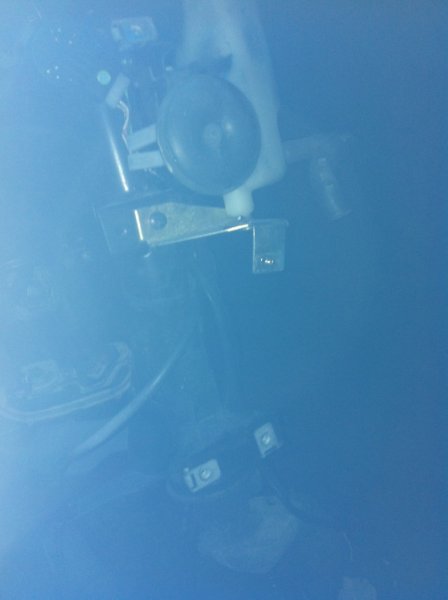

    Anyone got a picture of it ? Need to know how to mount my rad on as converting to lc.
  2. ramo
    ramo GoldMember
    1,572
    Can probably get a pic when it stops raining
    On the zips with radiators (SPs) there is a bracket welded onto the frame IIRC for the bottom of the rad which you might have trouble with as im not sure if theyre on all of them

    Yeah there's two mounting spots on the frame but I don't see how it mounts.
  4. ramo
    ramo GoldMember
    1,572
    sorry for the shit pic..
  5. Jonnymarrw00t
    3,243
    Piaggio Zip 05 plate
    Photo's been deleted mate.
  6. ramo
    ramo GoldMember
    1,572
    My bad, reuploaded. Not too sure if its even helpful to you but yeah
  7. Jonnymarrw00t
    3,243
    Can't really see it, It's blue ? from what I can see. I've got that bottom bracket ? and top.
  8. ramo
    ramo GoldMember
    1,572
    Basically the rad goes onto the gold bit and the two bolts under it iirc.
    And yeah the lighting was terrible i can get another in the morning if needed.
  9. Jonnymarrw00t
    3,243
    I didn't know if it mounted horizontal or vertical cause I can't fit it on all 4 bolt holes.
  10. ramo
    ramo GoldMember
    1,572
    Horizontally so the mounts are bottom and top. Think there is another plate that goes onto the bottom holes.
  11. Jonnymarrw00t
    3,243
    Ahh thank you :):). Been wondering the fuck ?lol. Something so simple.
