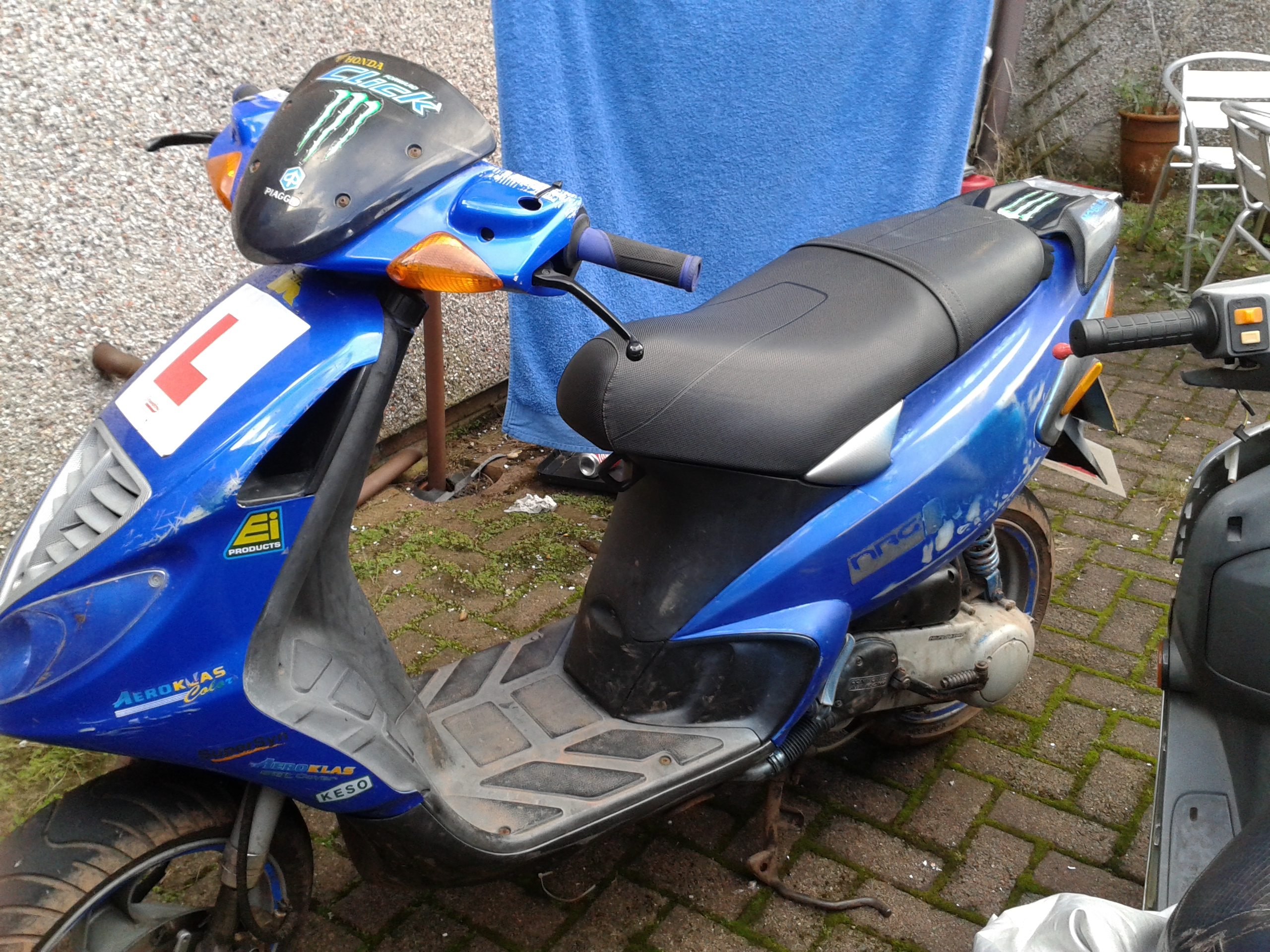

    Here is a pic of it once I got it home from it's first MOT failure, all I've done to it since this picture is
    remove the L plates
    wash it!
    replace the rear shock absorber
    attach some mirrors!
    It is now taxed and tested, so I can begin tinkering with it :D
    It also doesn't match my jacket or helmet, so seeing as every panel is scratched anyway, thinking a respray is in order!

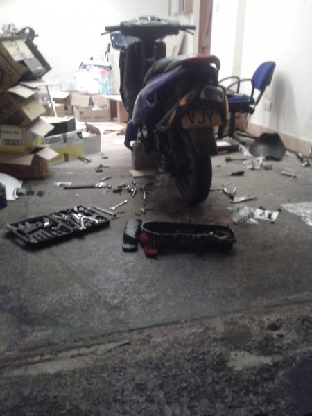

    The bike as it looks:
