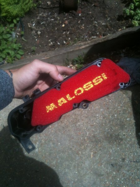

    Right I have a zip 50 cat 2001 it has a malossi filter and a 64 main jet I just fitted a derestricted zx exhaust and now it revs and dies I've tried every possible position on the mixture screw and fiddled with the idle screw but no luck any help please. Oh and the carb is a dellorto 17.5 but there is a tube coming out the top of the carb and it's blanked off? What and why is it like that?

    4.1 gram rollers in it now and its a malossi foam filter that fits in standard airbox the exhuast comes with 4.8 gram rollers what do you think I should do?

    he has a open filter aleast 75 80
  16. Creative_josh
    Creative_josh Piaggio zip
    127
    It's not a open filter? ImageUploadedByTapatalk1339239460.849261.jpg ImageUploadedByTapatalk1339239477.267847.jpg ImageUploadedByTapatalk1339239492.905394.jpg and can you see the tube blocked in picture 2? That sucks air in when the screw is out of it? And another question is the bike pulls away fine when you just start it up but then when it gets hot after 5 min ride it pulls away really slow like you pull the throttle back and it doesnt even rev for like 5 seconds? And then when it does start to rev it takes ages for it to pick up but then when the rollers kick in its fine again?
