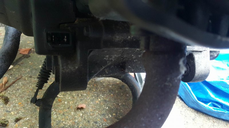

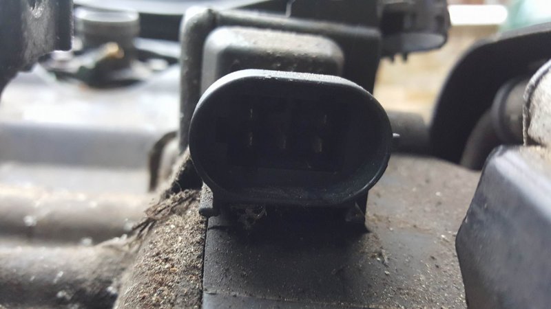

Thanks. But if I replace the CDI doesn't that mean I will definitely have to replace the whole loom? (I think if this were the case it would be too big a job for me as I am relatively novice at this). Regarding the imobilizer: I'm pretty sure the Fly 125cc from which the engine comes is an immobilized bike but my understanding was that the immobilization is contained in the 125 CDI and therefore if I did manage to start the 125 engine on the 100 CDI then there would be no immobilization to worry about? Sorry by switch I think I meant plug or connector- where the stator connects to the loom. Sorry there is not much light on the first picture but this shows the socket for the stator on the old 50cc engine which I can't be sure but it looks like a 2 pin socket: Then this is the actual plug coming from the bike which I have actually now managed to plug into the 125cc engine (but whether it works or not remains to be seen...) Again apologies for the picture quality: And finally this is the socket on the 125cc engine that I have now managed to plug it into:
socket on the 125 motor looks to be the stator connector , seen the piaggio stators coming with that type of block connector same with the 50cc, that looks to be a stator/pickup connector block again the 50cc 4t fly stators have that two pin socket where the 125cc has a 5pin it looks like. not a fan of those piagio Hyper4 /hyper2 motors they messed around with the connectors and likes trying to be cool and having the conenctions ported into the motor casing instead of a wire harness coming out leading to a connector block what we are all used to. means having to decamp side casing just to see the wires and where they lead to on those pins.
I will give it a closer inspection tomorrow but I suspect you're right about the connectors being different. Yeah I think the thing you're talking about with the porting onto the motor casing is a feature of the 125 but not the 50cc engine, to the effect that because of this porting I had to remove the CDI from where it's bolted into the frame in order to fit the engine and now would need to find a new location to tie in the CDI... If as we suspect the stator on the 125 is incompatible with the wiring of the bike, is there any kind of replacement stator that I could buy that would be compatible with both the wiring of the bike and the 125 engine?
i will have a look around vince and see. maybe worth you googling the search term piaggio fly 125cc stator upgrade possible someone may have run into this kind of problem else where and found a stator direct swap that worked , but i think its to do with were trying to fit a 125cc stator into a 50cc/100cc loom that could be incompatable. i dont think there is an easy fix for this to be very honest with you. 125cc looks more like a leader motor style, where the 50cc/100cc is a hyper2 style very differnet wiring.

This is an easy fix, The leader plug's 5 pins are the 3 phase, one pin is the oil sender, the last pin is the pickup, you will need a 3 phase leader regulator £16·00 pedparts, this has five connections 3 phase wires in, the two out are a stable + & - @ 12v connect to the battery (charging your battery) . Connect the oil sender wire to the appropriate wire that lights up the dash warning light. You are now left with the pick up pulse wire, simply put this piggy back into the 100's cdi input + wire (connect everything as before). The power of the125 will be down as the 100's ignition spark advance curve is well retarded to match the 100's flat profiled camshaft to prevent engine knock on the hiper4 engine. Cheers Andy.
