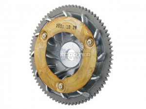

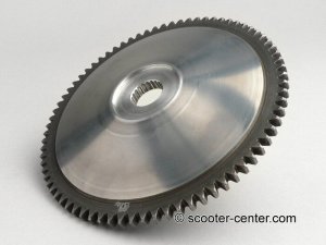

    Right finally received pulley for piaggio x8 today
    Normally has a metal ring ring on top of the pulley but mine has come and as not got one,
    Is this going to make a difference or not.
    ip32439.jpg old one
    R25902(2).jpg new one
    What does the metal fan thing do also ?

    hi sutty,
    its saved you a job as the first thing i do is remove the ring its commonly known as the rattle ring because it always eventually loses its screws and rattles to fuck. its there to aid cooling but does fuck all apart from rattle.
    cheers Andy
