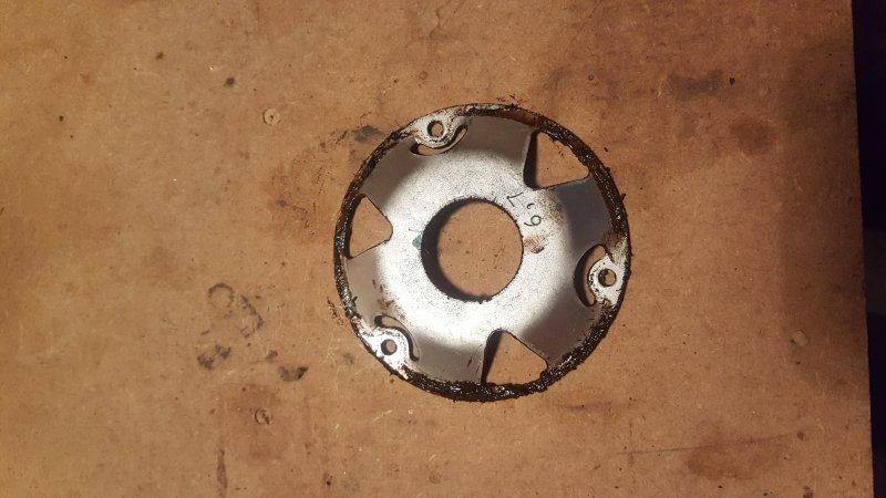

Well it worked!!! Although the back of my variator was slightly different as it had an extra backplate, so took this off and replaced the back and now does around 42mph!! Thanks everyone for your help and advice
