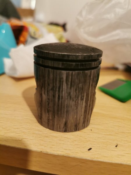

    Well, I took the head off and looked down the bore, looks shiny and OK. Piston head looked OK, a bit of carbon, but ok. Decided to take cylinder off and have a proper look at the rings and piston.
    Well, other than the piston is 14 years old, I think that the picture shows why it didn't run.
