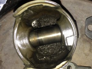

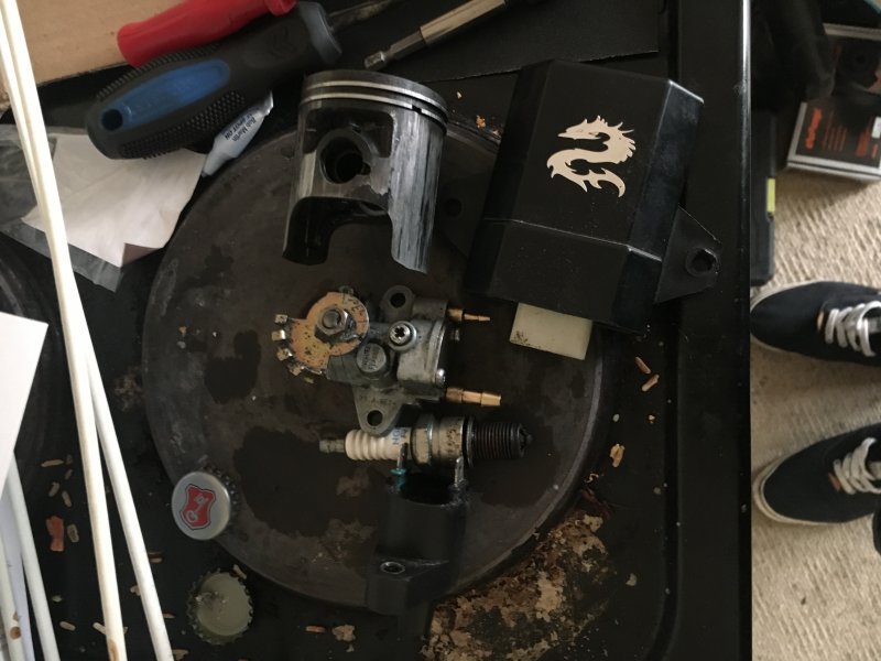

    ok... bit of a newbie, so here goes...
    while using start button, fan spins, but doesn't bite... sparks every time
    oil pump isn't sending oil to the engine, so replacement on order (hopefully arriving tomorrow)
    new piston and rings on order, as original heavily marked and full of crap!
    already replaced CDI, coil and HT lead. other parts on order: starter motor and starter relay
    anyone have any ideas why she ain't kicking?
    [​IMG][​IMG][​IMG]

    those rings look sort of melted on and the piston looks heavily scored ? do the rings move ?

    order a new small end bearing as well. a new gudgeon pin should come with the piston

    looks like you will need to sand the barrel as well, could you upload a pic. the burn marks down the side of the piston is where the burnt fuel has been going. and with exhaust gasses mixing with the incoming fuel/air mix and the lack of compression means its a no go. oil pump not working is obviously why the seizure happened.

    it will run again. I had broken rings a month ago, engine just died. so same idea. It would be a good idea to get a top end gasket kit as well seen as you have stripped it down. but with the marks on the gudgeon pin I think the small end bearing will be worn, and pretty rough, thats if it still exists.
    Give the crankshaft a soak in 2 stroke oil while your waiting for parts to arrive, you will need to wash out the crankshaft and bottom end with a heavy mix of 2 stroke and petrol to get any small pieces of metal shrapnel out and get things as clean and lubricated as possible before reassembling.

    the Piston : if you look the underside of the piston is black thats where its burnt underside a lotta heat has gotten under the piston and started to burn and carbon up. the side skirts of the piston show what we call blowback, this is what happens when the rings start to fail, the create less of a seal and that hot combustion gas then seeps down the side back into the crank case heating up the motor even more that escape of gas also creates hotspots in the piston crown where the gudgen pin is and the little end bearing , this can cause the gudgeon pin to seize.
    its a classic sign of a bust oil pump and a lean senario where the bike has overheated to a point the rings have failed and the piston has started to become soft allowing rings to stick. this has caused a huge drop in compression and no amount of fuel - air and oil with a spark will ignite and if it does its only withing a min the bike will superheat and stall out due to the lean conditions.

    have you rebuilt the top end ? looking at the blue colouring on the gudgeon pin its seized and skidded on the small end bearing when overheated and expanded so I don't think either it, or the small end bearing would be very efficient for long, they may move freely for now but they will be different when hot if any of them has went slightly egg shape with the seizure.
