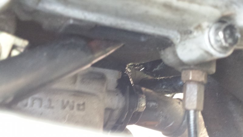

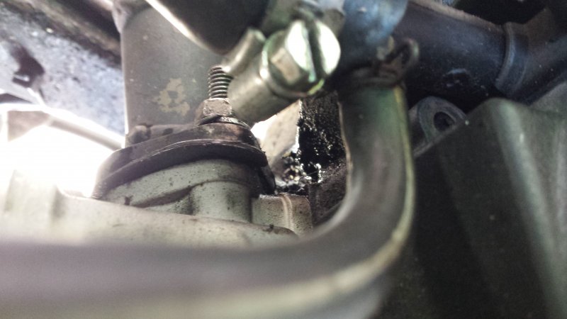

    Hi guys,
    Have oil leaking from what looks like the exhaust port, I've asked a few friends and they say its nothing to worry about and is normal for 2 strokes...So basically I am just looking for another opinion as I'd hate to leave it and cause some damage due to it.
    Thanks.
  2. scubabiker
    it is normal to have a little oil come through the exhaust, but if its coming from the port it means you have a leaking gasket (well some have that cone thing then just ignore it!)

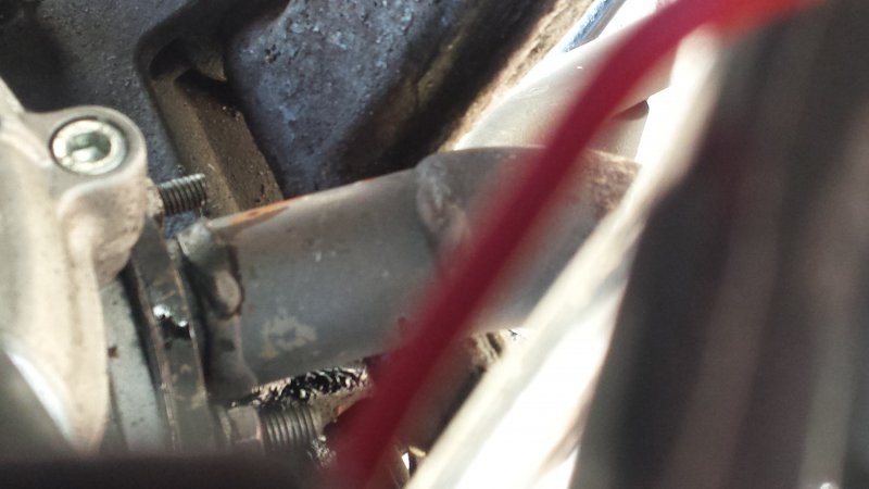

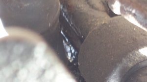

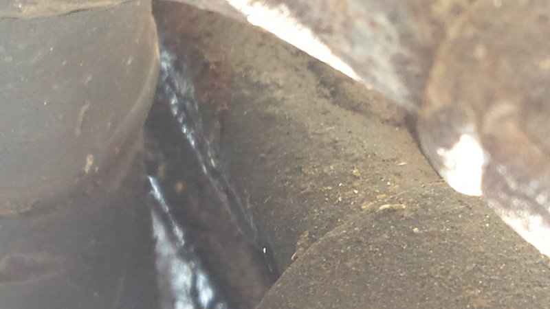

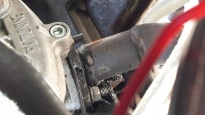

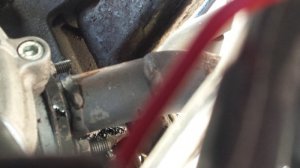

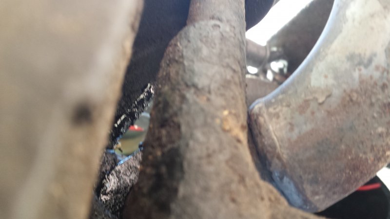

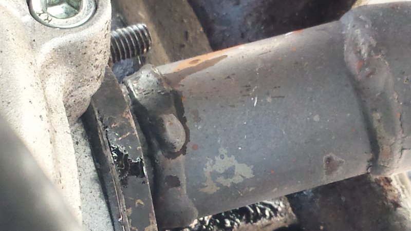

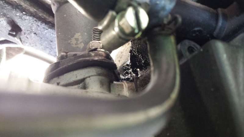

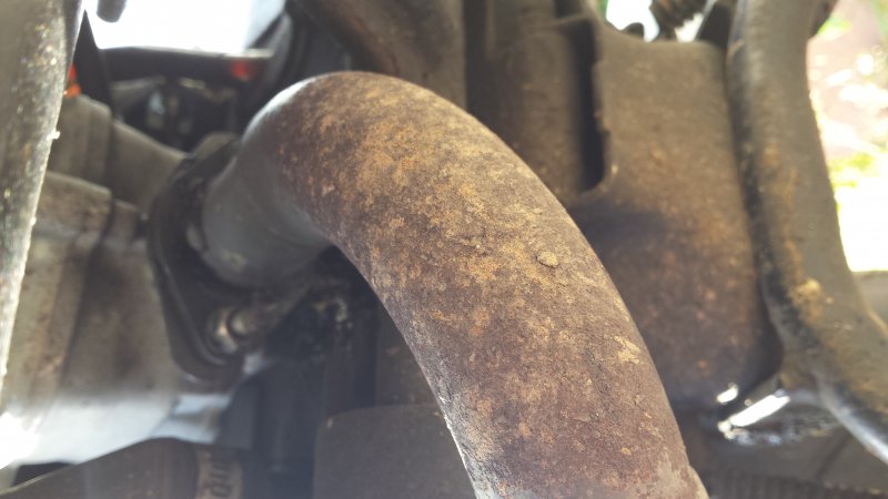

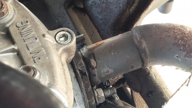

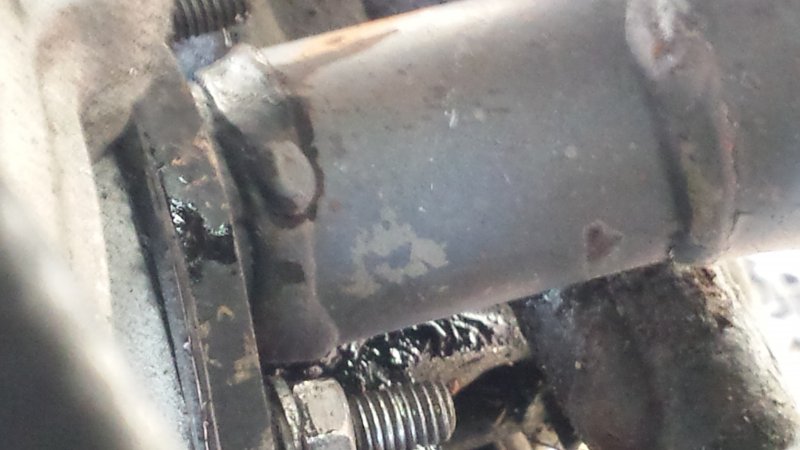

    Here are some pictures(a lot of pictures..)
    Help is much appreciated:)
    derp likes this.
  7. derp
    derp Member
    54
    Piaggio Zip 50 2t
    Looks like a leeking exhaust gasket. Really cheap and easy to replace :)

    I assume I should of mentioned that when it was rebuilt a couple months back(was sat, I've just ran it in not long ago) it was new, hardly had any road time so I assumed it wouldn't fail so quick lol.
  9. derp
    derp Member
    54
    Piaggio Zip 50 2t
    My exhaust is self sealing (aftermarket) so ive never had this issue. I assume a new gasket should fix it. Personally i wouldnt worry about it. Just make sure that exhaust is tightened up :)

    Its defiantly tight although I noticed instead of just plain washers it has some kind of spring tension washer instead, not seen this before.
    I will by all means buy the gasket and replace it over the weekend, nothing to loose, just didn't want unexpected issues with it during the week as need to use for work :p

    Well replaced the exhaust gasket, all seems fine.
