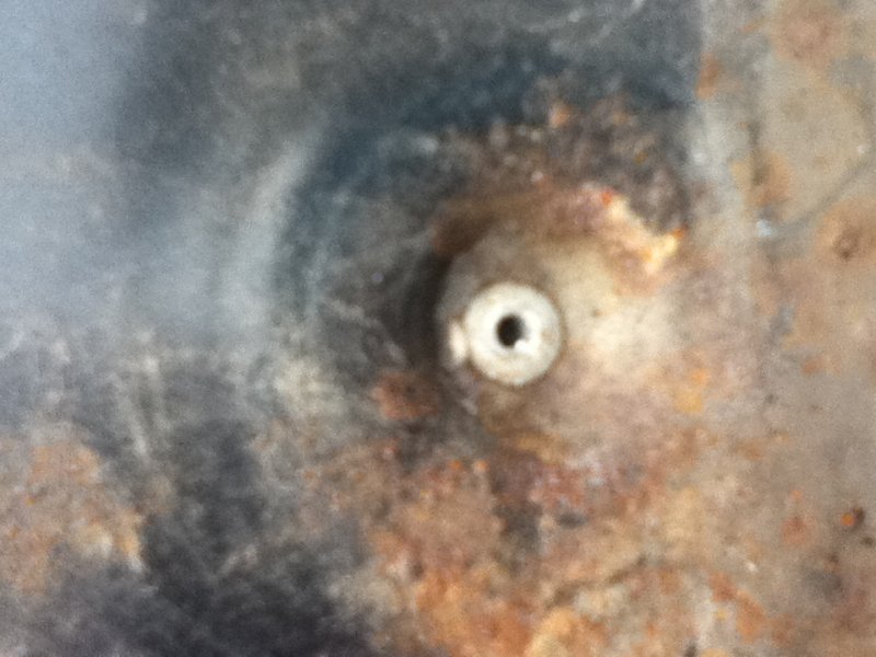

  13. pargy
    pargy pargy
    76
    05 typoon 50
    how do you get these off
  14. gilly_runner
    gilly_runner Member
    180
    Gilera runner
    To me that dont even look like a screw but a rivet, use a drill to drill through the middle of it then it will just fall off if you havent got a drill improvise and use a scewdriver or something to get it off its easy to do as there made out of soft alloy

  17. Stig
    Stig Well-Known Member
    1,462
    EXUP1000
    yes def a rivit. If you can get access to a drill, it doesnt matter how big the bit is as long as it covers the rivet head. Slowly drill into the head til the head breaks away from the inner section at the rear. the plate should then be removable. Tap the remainder of the rivet through using a punch/drift
