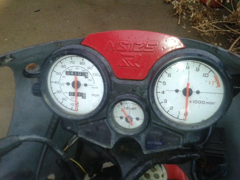

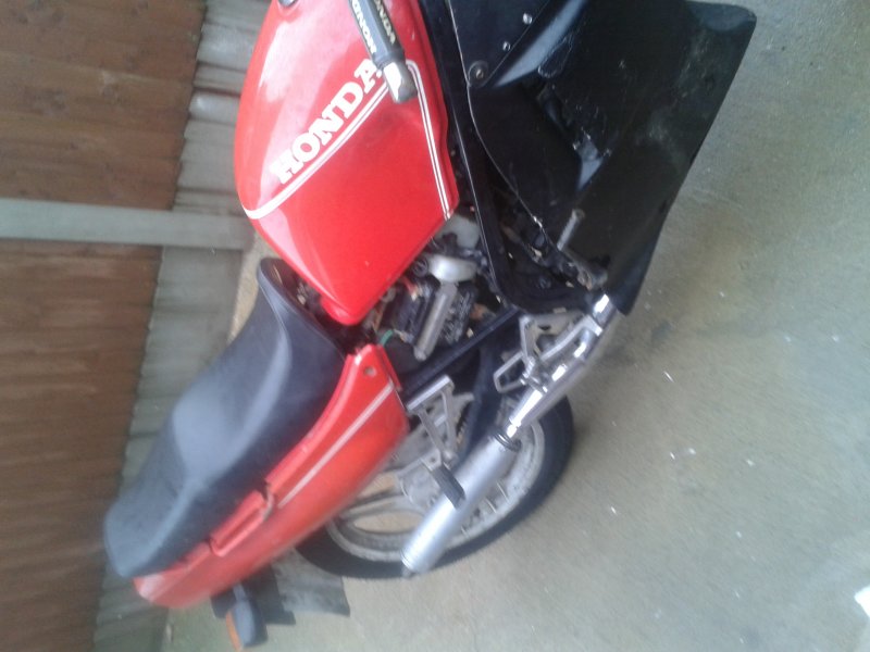

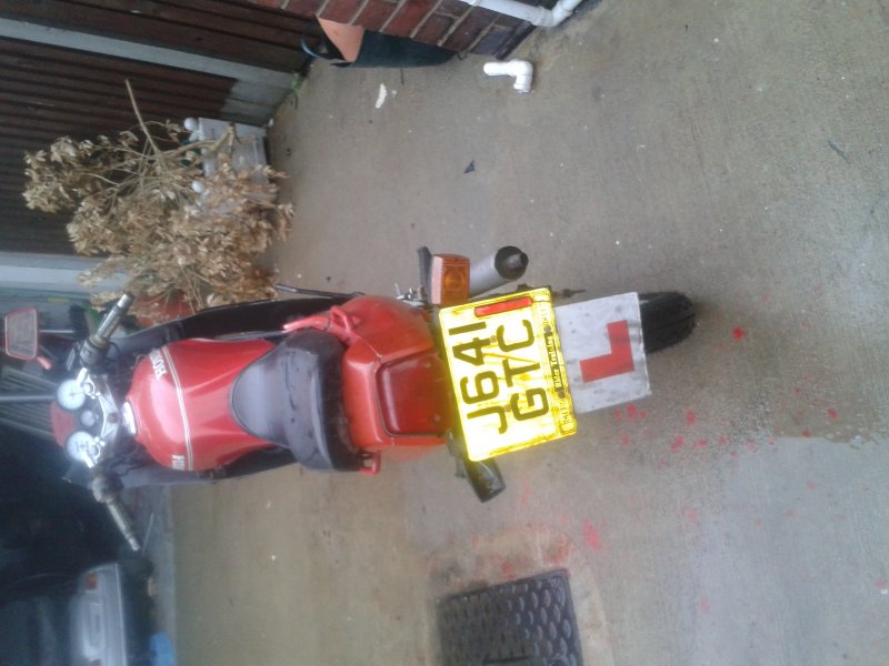

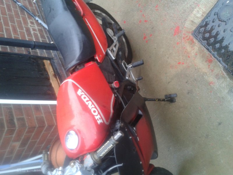

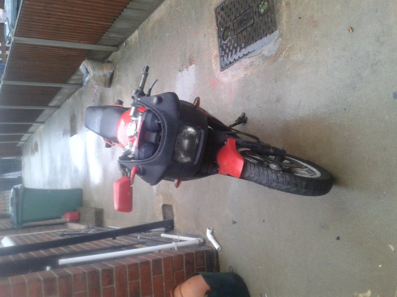

    It has been stood for over a year but has good compression and a good spark so when my dad wakes up me and him will try getting the old beast going here are some pics 2013-09-06 12.19.50.jpg 2013-09-06 12.20.02.jpg 2013-09-06 12.20.13.jpg 2013-09-06 12.20.23.jpg 2013-09-06 12.20.36.jpg

    i have no idea mate to be honest about the color code , and as for it been stood probably just a case of a carb clean and fresh fuel if everything else is good , nice little project you have there matey enjoy wouldn't mind something like that for my self

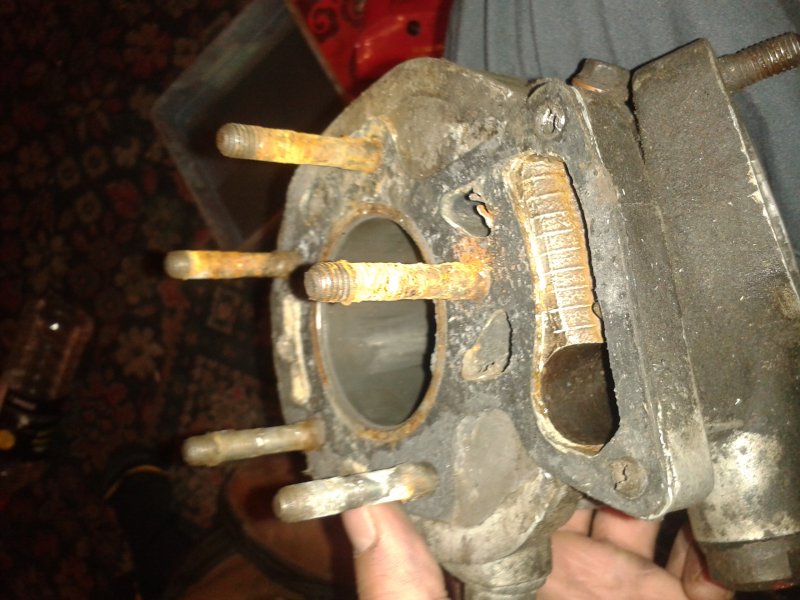

    Update got the old beast running but now in proccess of stripping it and doing a nut and bolt job some pics here and just uploading video to youtube right now looks like i will be busy tonight 2013-09-07 00.19.29.jpg 2013-09-07 00.19.45.jpg

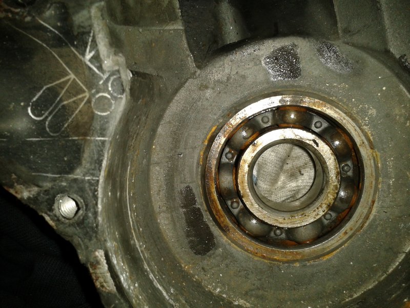

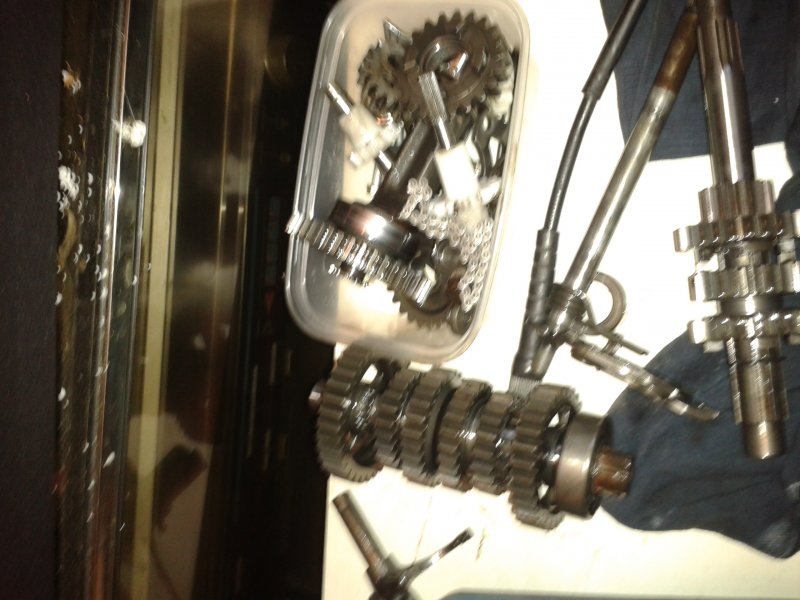

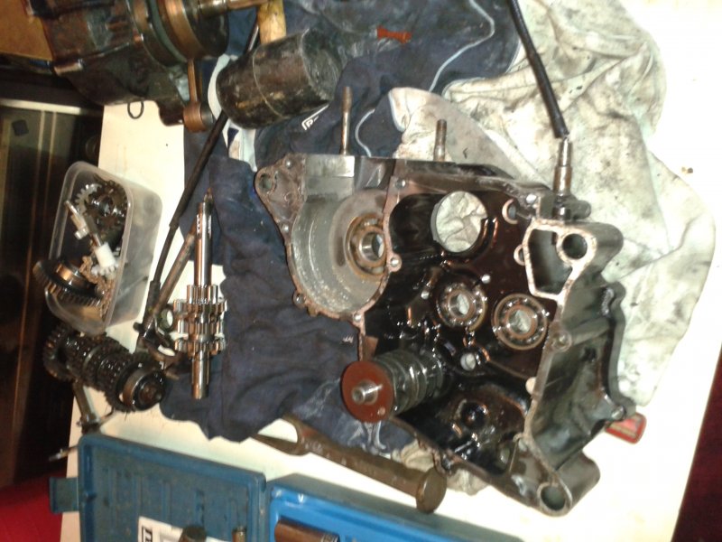

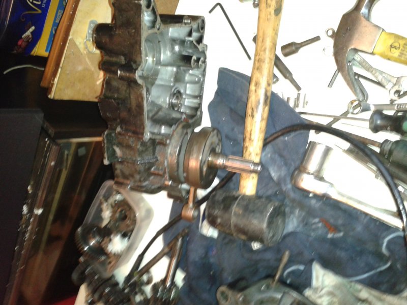

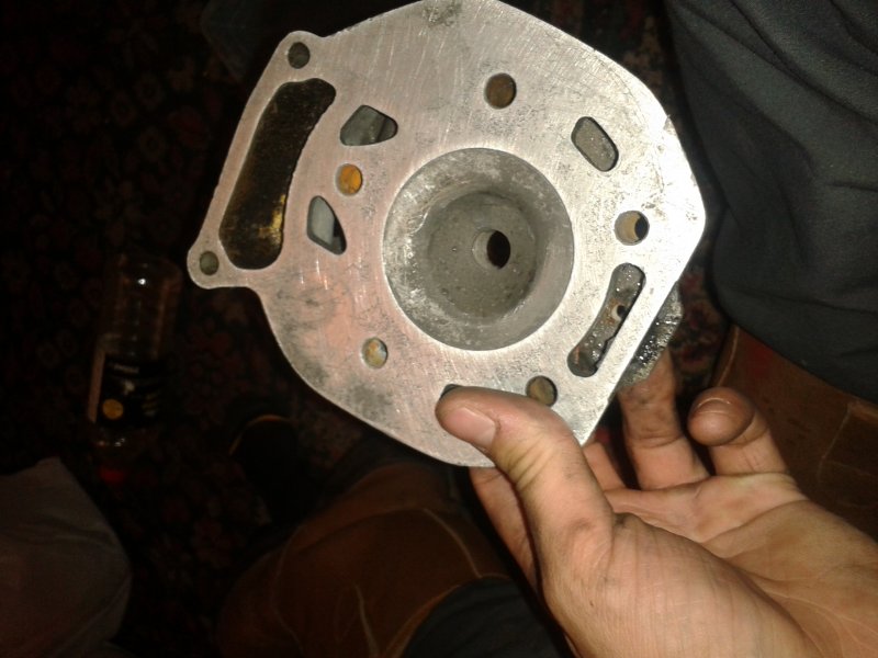

    So split engine 2 day orderd a new conrod kit and some bearings 1 in pic r as dry as gandys flip flops here r some pics hopefully engine will be built back up by next week 2013-09-10 18.28.05.jpg 2013-09-10 18.28.18.jpg 2013-09-10 18.28.27.jpg 2013-09-10 18.28.43.jpg

    Thanks for your input but yes it may look like a pile of crap now but will not when it's done the hint is in the title project
