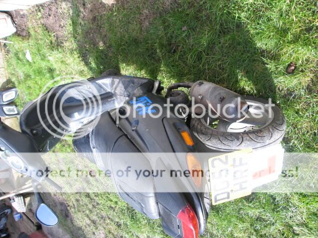

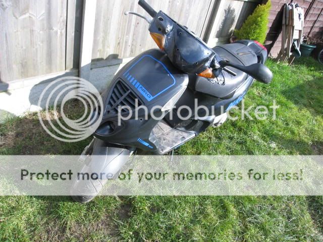

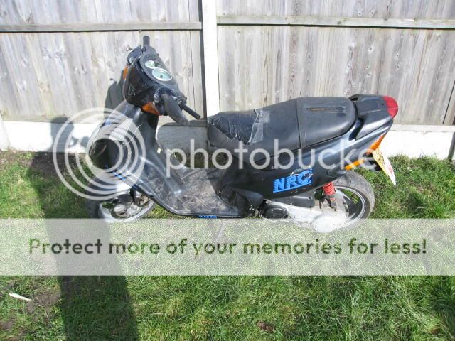

    picked up this nrg cheap of a freind who bought with intention of gettin legal but it never happend he never had it running so got it cheap, got it with papers and bit of tax no test though.
    So first thing was new plug had spark but werent started so checked the carb and it was full of crap so ripped it out and cleaned i up also took out manifold and checked reeds looked atda the size of them and nearly wet myself the manifold has the smallest hole i have seen and the carb was only 1 14mm so changed them to bigger manifold and 17.5mm carb also changed air filter as one with it did not fit to one i had of an nrg power and it now runs perfectly bit of a wheely machine also changed the broken main stand to a side stand.
    Well parts it needs are new panels as dont really wanna spray um as trying to sell it after the work is done seat cover, front inner and seat bucket so if any1 got any of these parts let me knw :)

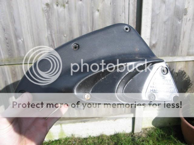

    im sure they're more restrictive the the triangle box you have
  3. RunnerDave
    RunnerDave New Member
    75
    Runner 125

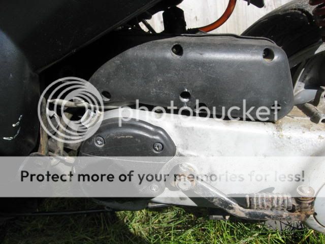

    triangle one dusnt fit the bike tho but have made a bigger hole in the air filter on the bike and runs pretty fine does 55 clock speed
  4. PrettyDodgyDave
    PrettyDodgyDave Member
    975
    Runner 180
    hmm i pulled a nrg enginre out the otherday with a triangle box and it fitted just fine?
  5. RunnerDave
    75
    Runner 125
    :confused: this one seem to fit but the pipe does not reach to the carb but not really looking for performance anyway as selling it on se just need a good runner thats looks half decent
