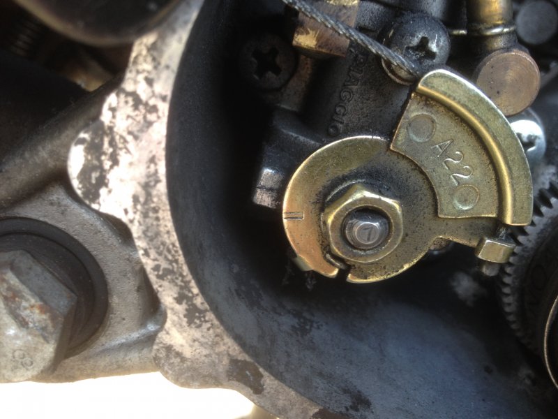

  5. NRG2002
    NRG2002 Member
    114
    [​IMG][/URL][/IMG] oil.JPG
    Taken a while but at last got out today to take a pic,i notice that the marks on the throttle are not lined up,it has a 70 kit on it already,has this been done on purpose cheers
  6. Stevep
    Probably not, many people don't know about how to align the oil pump, but as I said in an earlier post if you are concerned that the piston isn't getting enough oil, then add a bit straight to the fuel when you fill up.
    You have to remember that it is a 2 stroke engine and the piston will go at some stage, no matter how well you lubricate it, that's just the nature of the beast i'm afraid. Regular compression tests can tell you if the rings need changing, but i normally say every 6000 miles stick a new piston kit in.
