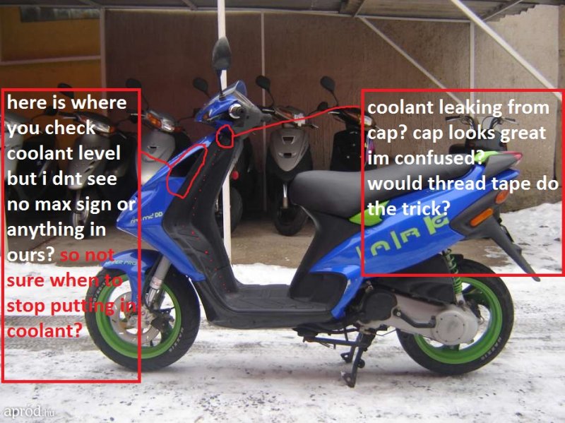

    my lil brother nrg (liquid cooled think its a mc3 dd)
    well ill just right everything in pic
    please respond guys
    ps this isn't my bros ped (just same ped as hes out so cnt take pics)

    the bottle doesn't have a maximum fill level, but you want it about half way up, it's a overflow bottle, however coolant shouldn't be leaking from it, I'd make sure you have no air in your system

    when you say bottle (do you mean the coolant tank?)
    i have been filling it up with coolant until i just see the coolant at the neck of the tank (you know just a lil lower than where the cap goes)
    as for the leak would it hurt to try some thread tape around tank thread before putting on cap?
