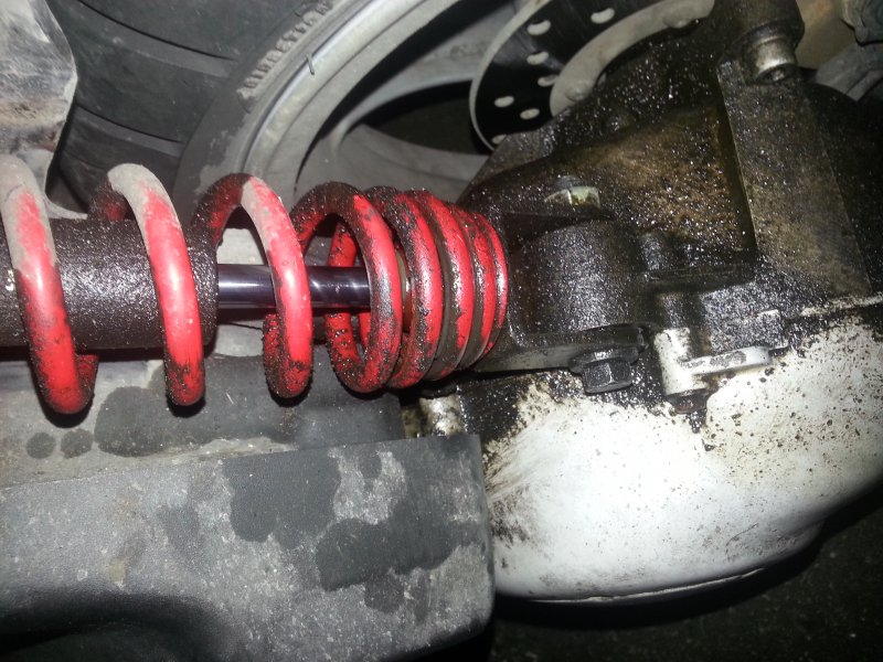

    hi all can anyone help me out please my nrg mc3 dd is leaking oil from the back shock anyone know if it needs replacing?

    Bounce on the back end, if there's no damping effect and just spring's back up quickly then replace it.

    thanks for the reply, it springs back up
