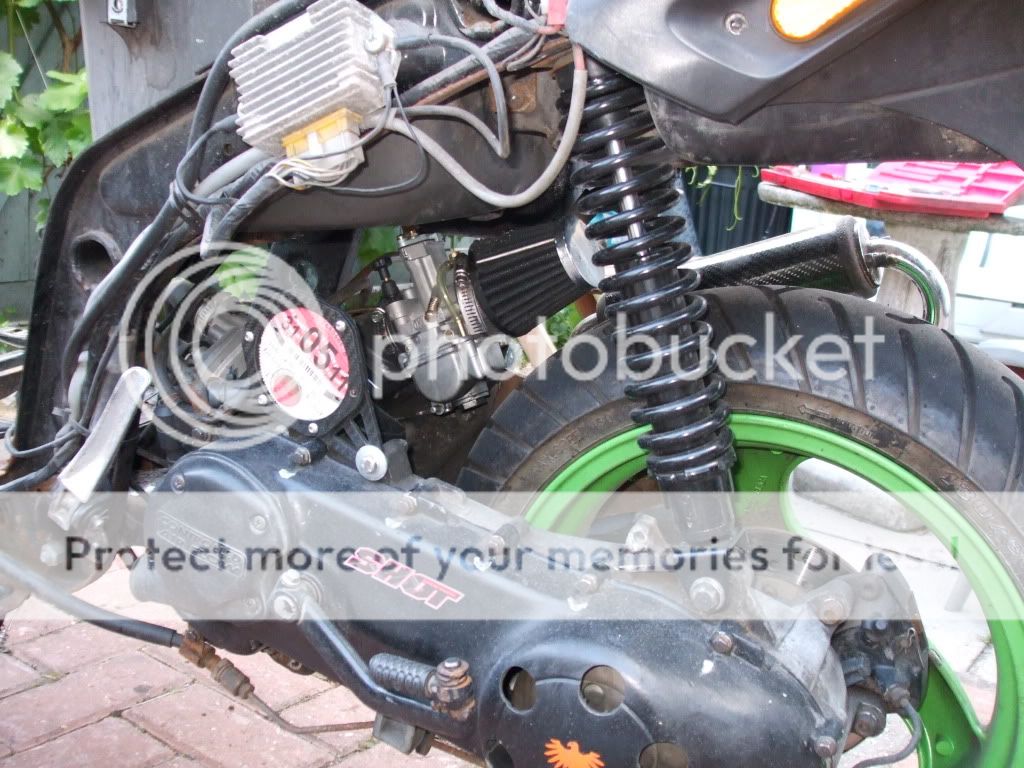

    Hey i need some ideas, tips that i could use to get my ped going faster.
    Its already hitting 70 at the moment and i recon i could push another 5 mph out of it but takes a while once its got to 70.
    My tuned parts
    Stage 6 70cc race kit
    Stage 6 race reed valves
    Straight manifold
    Uprated clutch springs
    Downsized belt
    24mm OKO race carb
    Chrome endy exhaust for 70cc engines, now i am thinking of putting a Yasuni C16 exhaust on, i know you can get Yasuni C30 but it costs quite a bit.
    Update :)
    How it used to look before i crashed xD
    Re-spraying bodyworks
    Thanks for viewing :)
    If you could please put down some parts i could add to my Ped then that would be great of you! :D Thanks.
