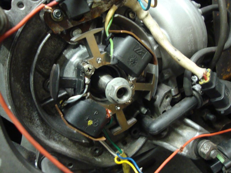

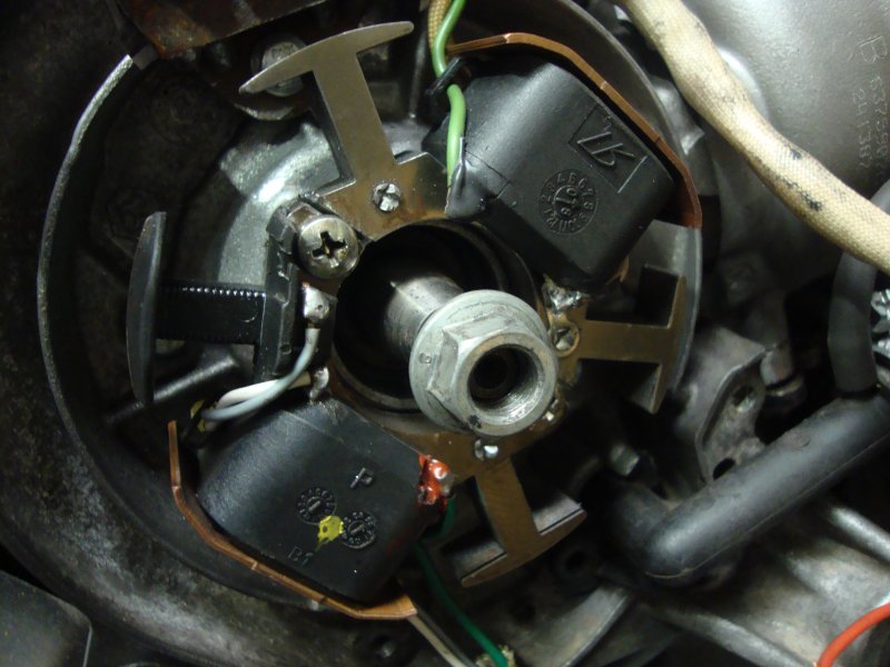

    Not to bad, still having issues with ignition. Have ordered two new pick-ups to try, as soon as I rev it up it start's to miss fire, tested pick-ups and found different Ohms readings??
  4. scubabiker
    hmmm maybe they are causing interference with each other? could be worty running wasted spark (can you do that on a 2 stroke?) and see how that goes?
  5. MARSH
    MARSH Whooooo!
    3,266
    Piaggio Typhoon
    I have thought about that, I'm thinking it's not creating enough power to run two cdi's? It start's on the button first time every time, tick's over great, come to pull away and it's missing and running on one cylinder! I need to check the stator again to see what I can do.
  6. scubabiker
    have you tested the coils? its worth checking that. how differnt are your resistances in your 2 pickups?
  7. MARSH
    MARSH Whooooo!
    3,266
    Piaggio Typhoon
    One at 105.6 ish and 125 ish, they should be within limits but who know's! I now got 2 new pick-ups, I'll change the stator as well.
  8. MARSH
    MARSH Whooooo!
    3,266
    Piaggio Typhoon
    A little update, Have cut up two stator plates to make it with two ignition coils and it work's a treat! It goes like f*ck and want's to wheelie off the throttle, just need to jet it a bit more, rollers/clutch etc. It's like a light switch, a bit flat then revs pick up and off it goes. Might need to fit primary gear kit up as well as the secondary it's got in already! 2015-07-03 23.13.05.jpg 2015-07-03 23.13.18.jpg I need to rewind the coils to get some power out to charge battery but that should'nt be to much trouble.

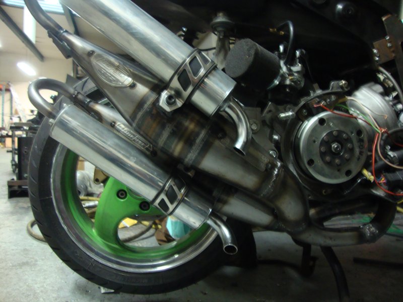

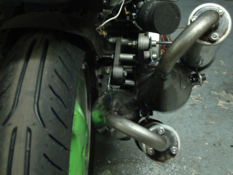

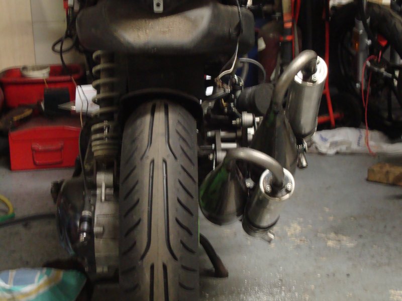

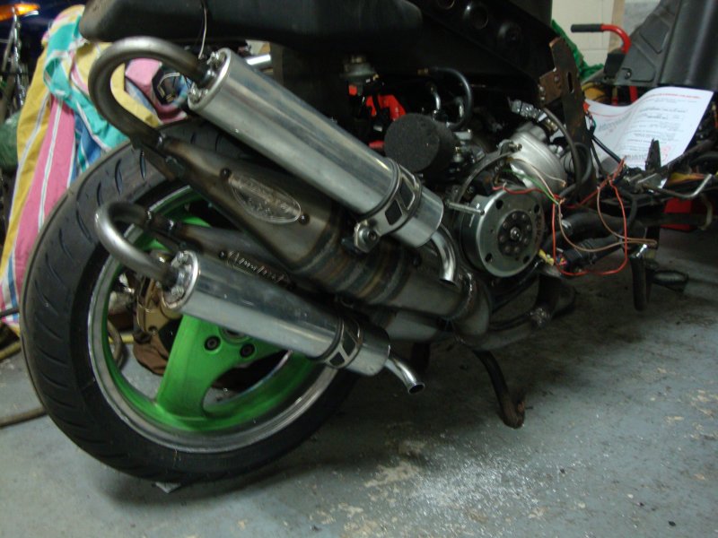

    I've cut and remade the outside pipe to fit a touch closer! 2015-08-27 07.26.08.jpg 2015-08-27 07.26.46.jpg 2015-08-27 07.27.05.jpg 2015-08-27 07.26.27.jpg
